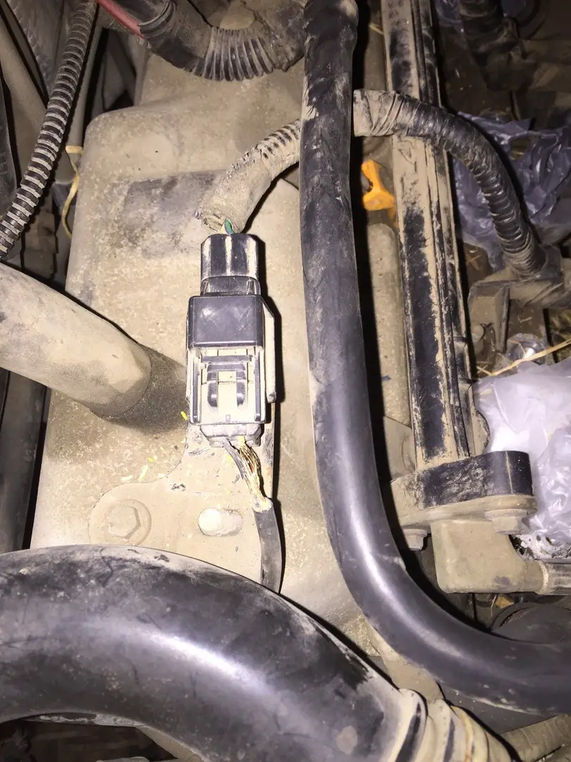

Does anyone know what this pictured connector is for? I had a squirrel make a nest under the intake of my 01 Sport Trac and of course it had to chew some wires while it was there. I'm trying to get it straightened out but can't figure out where one goes. It is the connector that is on top of the passenger side valve cover. It comes from the main harness bundle under the intake, up to the pictured connector, then down by the coolant temp sensors (which they also chewed up) but that is were it is chewed off and don't know where it goes from there. The wires are yellow and black or gray. It did still run and drive with the severed wires. It seems I lost cold AC if it could possibly be related.

Honda (and maybe others) has come out with "rodent tape", its like electrical tape that has pepper sauce in it to keep critters from eating the wires. From what I was told the shielding around wires is soy based and that's why they like to eat it.
The only thing under the intake manifold (that I'm aware of) is the knock sensor, so swhawaii is probably correct. The engine will run pretty well w/out it connected. The knock sensor alerts the PCM of pre-ignition/pinging so that the PCM can retard the ignition timing a bit. Until you get a replacement connector run premium fuel to be safe.
Thanks for the info. I have all the parts and now I just need to put everything back together. I can't seem to keep the rodents out of it. This will be the forth air filter in it this winter/spring because of mice and squirrel nests in the air box.
