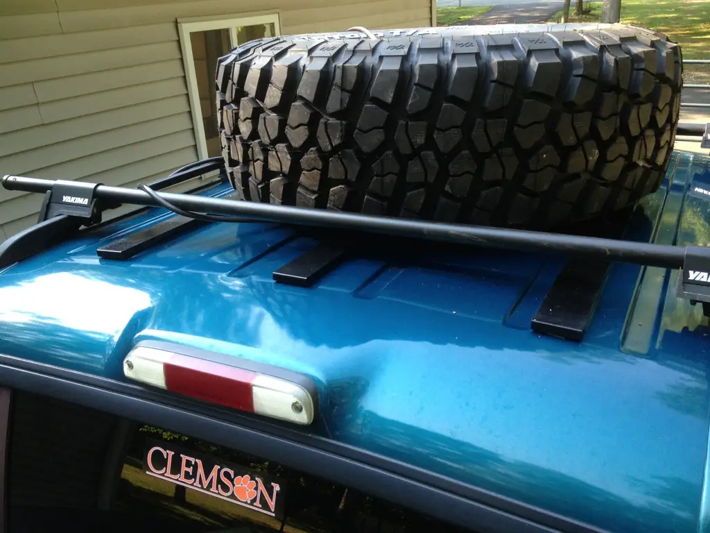

I really like the Yakima bars. They didn't add any wind noise for me and were really easy to install. I have spaced them out so that my 35x12.50 tire fits snugly in between so i can strap and lock it down on trips if I need all the space in the bed.
To keep from damaging the roof and to spread the weight out better, I went and bought the biggest vinyl cutting boards I could find into 2.5'x2 or 3" strips. I painted them black and stuck them on using outdoor 3M double sided tape. I put them on similarly to the strips on the roof of 1st and 2nd gen Explorers. The reason I did this instead of a basket is to keep the tire ~4-5" lower than if I had a basket.

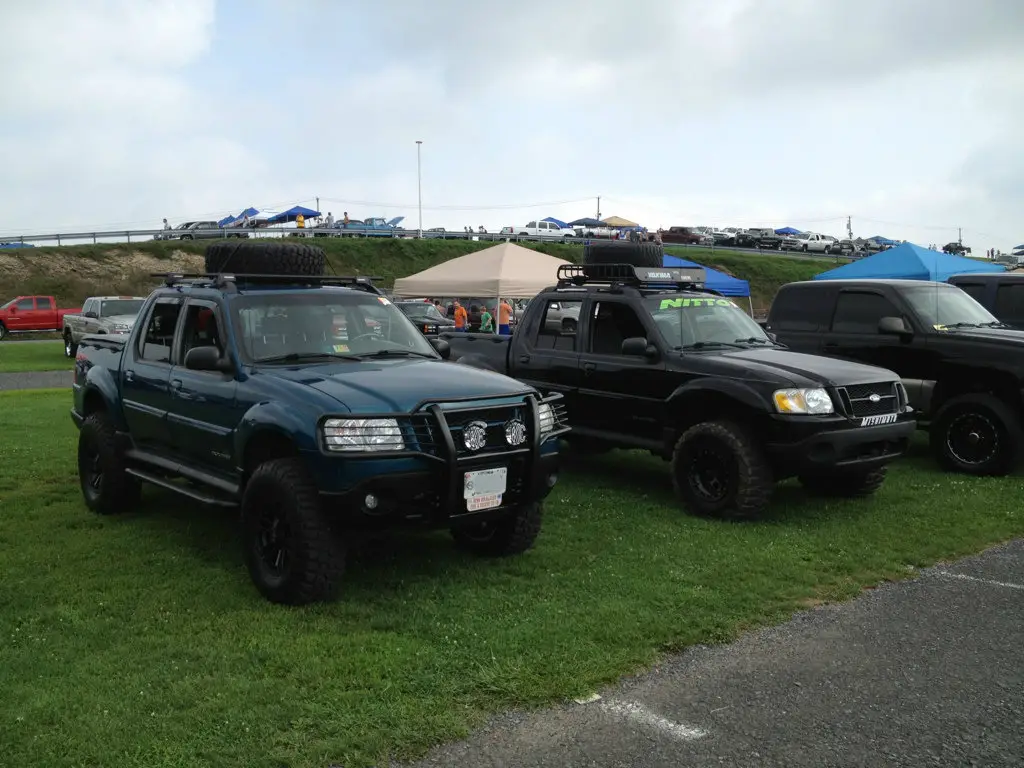

You can kind of see the black strips in this picture. I'll try finding a more close-up example.
Here's a close up
