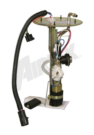

You have a returnless fuel system. The fuel pressure at the Shraeder valve should be 60 to 65 psi at all times. The fuel pressure regulator is in the tank. There is also a screen (sock) that filters the fuel from the tank to the pump inlet. There is a fuel pressure damper on the fuel rail. It is located on the driver side near the firewall. Since the pump runs for a few seconds at ignition cycle the problem is probably not electrical. I suggest that you replace the fuel filter if it has been more than 30,000 miles since last replacement. I don't think it will solve your problem but it may make your existing or future pump last longer. Below is a photo of a returnless fuel pump posted by ranger7ltr.

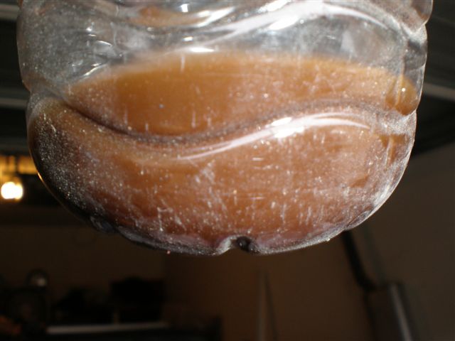

At least you have been driving your truck the entire time...I bought my 99 Sport in 2008 and it had been sitting for over 2 years with a half tank of fuel in it...That plus the metal tank was only half full led to an extremely rusty fuel tank...I changed filters every 2-3 months dealing with the dropping fuel pressure until I changed the tank and the pump for the last time...Oh and I had to change pumps 3 times before I changed the tank.. The rust was passing straight through the pump filter and grinding my pump to death...
The picture is what I drained from the inlet side of the filter each time I changed the filkter before I changed the tank...I hope the fuel from your inlet side of the filter looks better than that...
Let us know what you find...I know I am curious...
