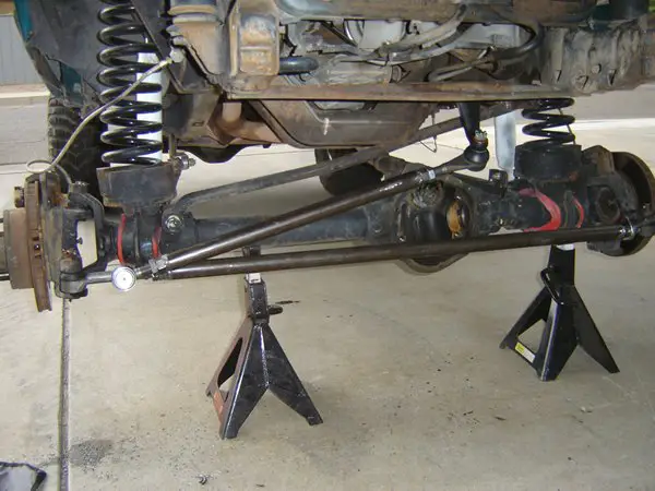

Here are the clearance Pics I ended up with the perfect amount of room. These steering components are HUGE! :) Makes the pitman arm on the steering box look tiny. Shouldn't be able to break any of it. I have 1.5" .250 wall DOM tubing that connects all parts.
Should have to cut off about 2-4" for the drag link. Not sure on steering link since I don't have the steering box in and truck in the air. Also roughly with toe set it is 54 1/2" form center of steering hole in knuckle to the other. It wouldn't be long enough if it didn't have that real long right tie rod end for the T-Link steering.
The worry was that the wheel sits over the steering knuckle. Those pics I guess don't do it justice. There is plenty of room. But I also though that with a 5" backspacing that it was measured to where the bead of the tire sits. When in all reality it is measured from mounting flange to the VERY outermost edge of the rim. Which on any rim is 1/4-1/2" out further than where the bead of the tire sits. Hence why there is a little more room than I expected.
Here is a picture that you can better see that the tie rod ends do sit fully inside the tire if you look at it from the sidewall straight down you can't see ANY of the tie rod ball joint. All you can see is the threads where the DOM will be. See you can barely see the ball joint of the tie rod now if you where to walk a little to the left and look at the tire straight on you wouldn't see it at all. It is tucked in there good. :)
Here is the normal tie rod end laying on a 2X4. Nice and stout!
