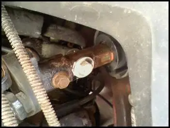

hey i got this same problem! I'm stumped on what to do as well. I know the extension is in, and I got a '92 X...
I didn't measure (I didn't install it) but that is the pic of it. The extension is the bolt to the right (shinier/ bigger one.)
Thanks for all the info, and I did the extension. I took the brace holding the steering column off right under the dash. There is hard plastic right where the bolt holes are. I grinded the plastic down till it was flush with the aluminum. This raised the steering column up about 1/8 of a inch. It straitened out my shaft just enough to fix the bind.
