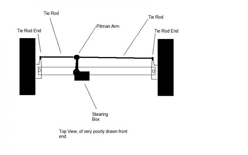

Think about it logically, see the diagram below, the pitman arm is attached to your steering column (through the steering box). Well on the gen2's there is no pitman arm, but you get the point same properties apply.
The tie rods adjust the alignment for toe in/toe out by lengthening or shortening the tie rod. Your steering wheel is off because the person that set your alignment did not adjust both tie rods evenly, therefore your pitman arm was not properly centered. Now lets say your steering wheel is to far to the left, that is as if to say the top center of the wheel point to the left. this means that the center of your tie rods is too far to the left so you would need to lengthen the left rod and shorten the right rod the exact same amount to move the center more to the right.
The key with doing this is that you move the left one out the exact same amount that you move the right one in, that is basically very simple by counting the flats on the end of the tie rod (I will get into this more later). If you do not move each one exactly the same amount it will mess with your alignment and your truck will need to be re-aligned.
OK so that is the theory of it all, how do you do it. Well on the ends of each tie rod there is a threaded adjuster. They are both standard right hand threads, with a clamp that holds the threads from slipping. First you need to figure out which way the steering wheel needs to go then guess on how far. Small adjustments here make a big difference start with a little and work your way up until you get your wheel centered. Mark the starting points on each tie rod end so you can return there if things get messed up. You should not need to go more than a few flats on the adjustable ends. Remember they need to god in the opposite directions, and the adjusters are facing opposite directions so to shorten one and lengthen the other they will both be rotated in the same direction (I hope that makes sense). The last thing you want to do is get in there and adjust them in different directions which will either lengthen or shorten both sides messing up the alignment.

It is harder to describe than to actually do, just use your head and think it through. The first time I set my own alignment I had to re-do it 5 times, but now the concepts are in my head it is very easy. This is way easier than setting alignment. You always have your marks to fall back on if you mess something up. :thumbsup:

actually the newer trucks do not, but I drew a R&P because it is easier to visualize
