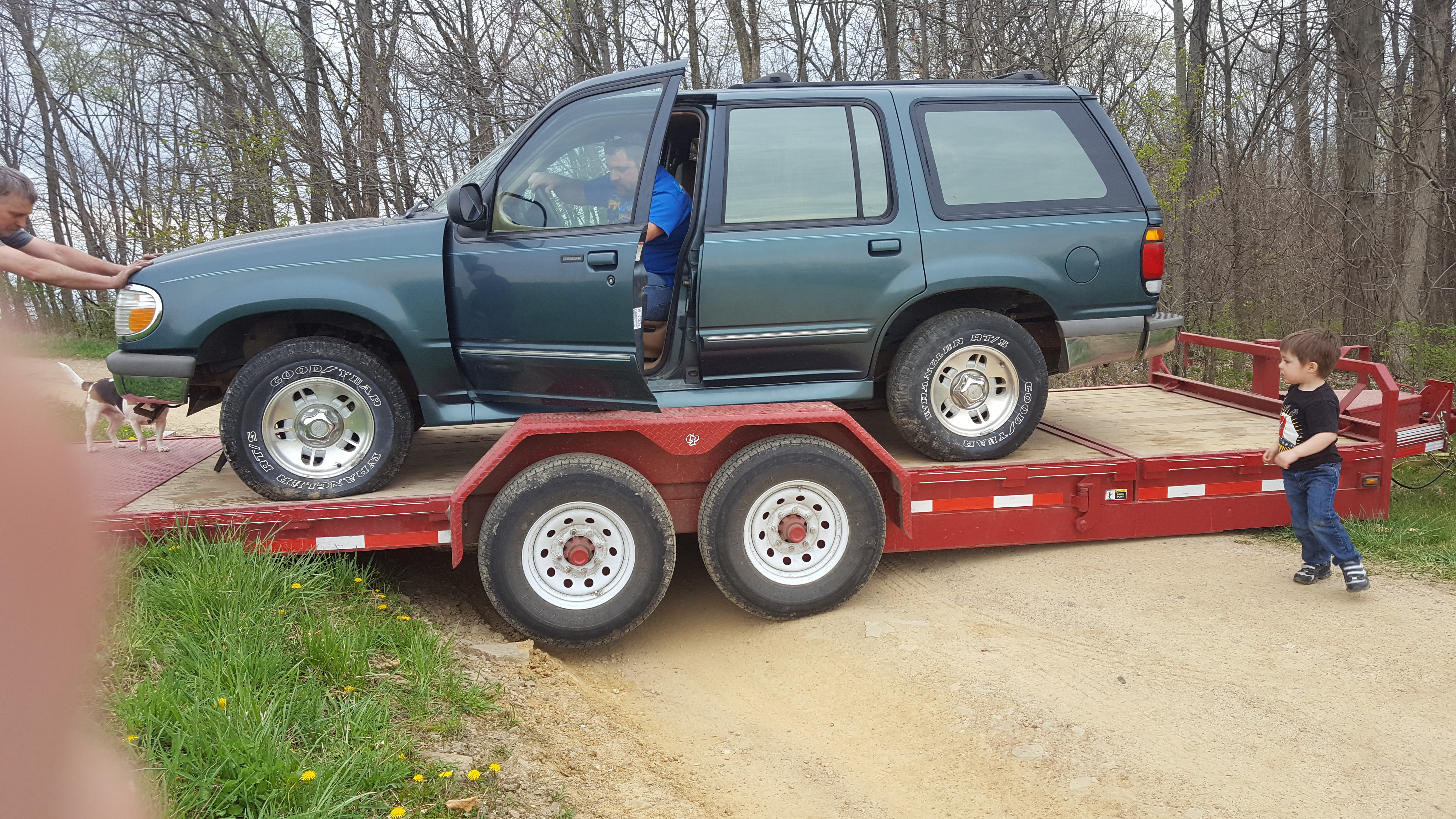

This is day one picking it up out of a field. The body is in great shape but unfortunately the undercarriage got really rusty sitting out there for over a year. Wish they would've kept it in the barn!!
Looks like a great looking EX. Look forward to seeing what you do with yours. I also have a 96. Mine have the running boards on it though that are gonna come off. When I get a chance I will be doing the TT and the AAL or Shackles this will do till I get all the parts I need for my Solid Axle swap.
