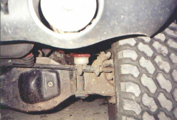

I'm helping a friend with his 90' Ranger SuperCab.
We have ran into som problems with the suspension. In the rear it's very very soft and the front has got quite a lot of negative camber.
Some previous owner have mounted a lift kit. But we don't have any information about it. No name or other facts.
I lifted the front (in the frame) and when the weight was off the front wheels the negative camber disappeared. Does this mean that too soft (worn out) front springs are the cause of the negative camber?
I guess that new leaf springs and shocks in the rear will take away the "softness".
Does anyone know some good suspensions dealer (which delivers over seas)?
