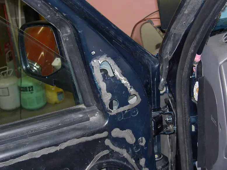

Josh, it's not a big wiring deal, though I had all 1999 wiring to work with. The hardest part will be cutting the two front mirror bolt holes larger(pic). Look at your top stock mirror hole, they are all round and it needs to be cut down for the plastic door panel hook to fit.

Yes, when you get a later front panel, look at the backside where the mirror switch is. There is a plastic hook which holds that top corner onto the door. Notice that your older panel has a screw next to the glass to hold it to the door.
It was a little time consuming to cut and whittle that slot for each front door, but it wasn't too hard. The hole in the picture above is very very close to being perfect. Follow those contours for the hole. You could also make a template from a 95-01 front door, that may be better yet. Trace the three mirror holes from a 95-01 door, plus that rectangular portion needed for the door panel.

Good deal. I appreciate it. Only problem is I don't have access to the interior of the door. But I don't think it'll be to hard, I'll just get the grinder tool, load it in the drill and go at it.
