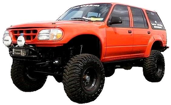

i have a 91 explorer that lays flat on the ground. i need new fenders and bumper so i was thinking about swapping a 95+ front end on it. it can be done, but i would really like to see a pic of someones whos done it previously. i only know of one and it was a lifted 4X4 off of another site. in your own opinion, what do u think about that? im also pondering a 98+hatch because i severely damaged mine during transport. thanx for all of the help fellas. lata

You mean like this...
Contact www.perrysfabnfiber.com
Steve
I think you wouldn't be well-served by the Perry's kit. It's got the big flared fenders, and those would look incredibly weird on a lowrider. I don't know exactly what's involved in the Perry's Fab swap, perhaps you could talk to Perry about buying the kit without the fenders and then pull fenders from a scrapyard? As far as the liftgate goes, I'd like to know too. I'm planning the full fiberglass conversion and I think I'd like to have a late-model liftgate so I don't hafta mess with license plate brackets on my redneck-bilt bumpers. :smoke:
