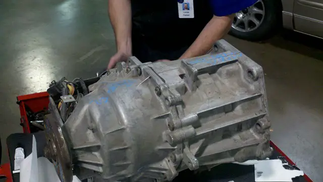

Pics of the old original T-Case (127,000 miles) Again it went bad because it was run dry of fluid.

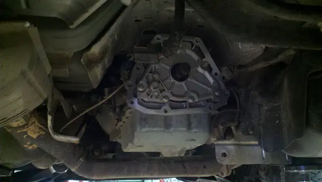

Pics of the T-Case removed from the transmission and the transmission cleaned up ready for a super thin layer of RTV and the new to this truck T-Case.
The T-Case from another 2002 Explorer 78,000 miles on this one.
