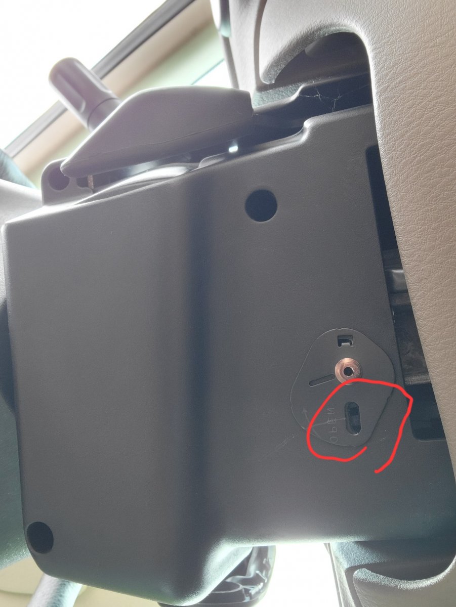

The purpose of this sensor is to control a shifter lockout solenoid to prevent the car from being shifted out of park when the driver's foot is not on the brake pedal. When the sensor fails in the circuit closed position, you will have your tail lights stay on indefinitely. When it fails in the open position, the shifter will not move out of park. If you are stuck in park there's a slot on the underside of the steering column where you can insert a flat blade screwdriver to manually release the shifter lockout. Other causes of the car failing to shift out of park can be a failed shift brake lock solenoid, brake light fuse, brake light bulbs. It's amazing that a $16 part can leave you stranded by either running down your battery or preventing the car from being shifted out of park!
