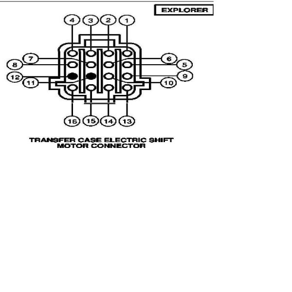

does anyone know how to test and/or the pin out for the hall effect sensors for the control track in the t/c? I have already cleaned them and changed the fluid with no change so I am pretty sure one of them is bad but money is tight and don't want to replace both if I don't need to.
Thanks
97 xlt 4.0 ohv, auto trans with control track
Hall Sensor -- Explorer
Hall Sensor Power
GEM sends a regulated 12 volts to both front and rear Hall effect sensors.
Check at the 16-way transfer case motor harness connector Pins 3 and 7 for approximately 12 volts. If no voltage exists, check for continuity between GEM Connector C3-Pin 1 and transfer case harness. If continuity exists, check Hall sensor Connector Pin 3 or 7.
Hall Sensor Ground
Check transfer case harness Connector Pins 6 and 8 for ground. If no ground, check for continuity between GEM Connector C1-Pin 21 and Pins 6 and 8, if continuity exists.
Front Prop Shaft Hall Sensor Return
Check for continuity between GEM harness Connector J3-Pin 6 and transfer case 16-way harness Connector Pin 4. If continuity exists, replace front Hall sensor.
Rear Prop Shaft Hall Sensor Return
Check for continuity between GEM harness Connector J3-Pin 5 and transfer case 16-way Connector Pin 2. If continuity exists, replace rear Hall sensor.

Thank you for the quick reply now I will just have to translate this to somthing I can understand. :confused: I know where the t/c connector is so that is not a problem but am unsure about the c1 c2 and so on connectors. I guess it would help if I bought a haynes manual.
a
test what you can first and maybe you'll find a bad sensor, if not, get back on here and I'll try to find more info for ya. C1 & C2 etc. I believe are connector 1 connector 2 on the GEM.

Hall effects work by with magnetism. They are simply a transistor that you can turn on with a magnet. Usually there three pins, +Volts, Reference (ground), and the switch line. Ohm these out first none should be shorted to the other, second with the power going to the switch, put your volt meter across two of the pins, take a reasonably strong magnet, not one of those off the refrig and wave it past the switch, first one pole and then the other and watch you meter for deflection. This will take some trial and error until you figure out which pin is what and the polarity. Visteon builds most of Fords electronic parts so if you need a switch you may have to buy one from the dealer. Also, in my business we use a lot of Hall effects, and their failure rate is very low. Hope this helps!
Wow so much info thanks guys. 1 question... I have heard of people frying their computers by using a less then 1 Mohm meter, is this a concern in this application?
Yes you want to use a high impedance meter.
