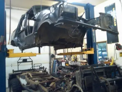

This weekend I have begun the process of giving the Ex-250 a new body...yes, the old one, after 9years has been worn out.
And while the body is off...why not throttle body injection?
