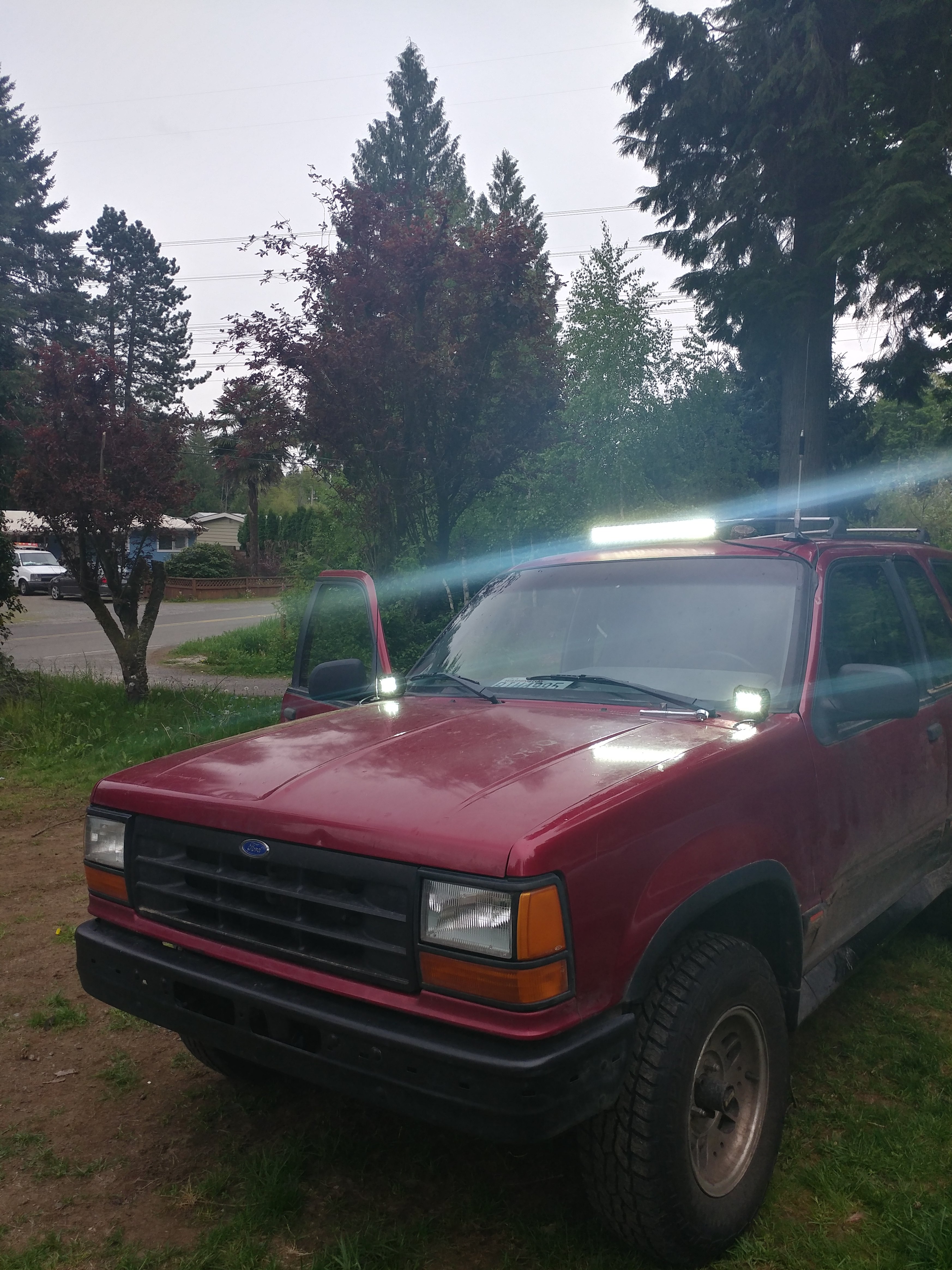

Recently put on a light bar and light pod set up. Soddered all wires togeather, threaded the wires where I could, put it all togeather and yay. New lighting set up that will light to woods up any where I go. I returned to the truck the next morning to take it for a drive and found that it wouldn't turn over. Lights on dash came on for a brief second then off. I thought I left my PA on or something so I grabbed my jump box, let is sit for a minute or two and she coughed once or twice but fired up. I went for a drive to the gas station about 5 miles away, turned it off, filled up and the same thing. No start. Used the jump box again, drove about 15 miles this time. In this time, the battery gauge was shaking back and forth between the top of "normal" and the bottom of "normal". I got home, turned it off, waited, tried to turn on..... Annnnd. Nothing again.
My PA and light bar are wired direct to the battery. I don't have a multimeter unfortunately so this is going to be a lot of guess and check. I'm thinking its either a bad altenator(its only a 95 AMP AutoZone altenator) or a bad battery(its a cheep walmart battery). The gauge does shake when I turn my headlights and A.c. on but not really when I turn the PA or lightbar/pods on.
Any help is much appreciated
At least she looks cool
Hey your lights look good. You know the 93-94 Limited alternator is 130 amp and it fits any 1st gen regardless of submodel -- and you can get that alt at any decent auto parts store. Just tell them you have a 94 Limited.
