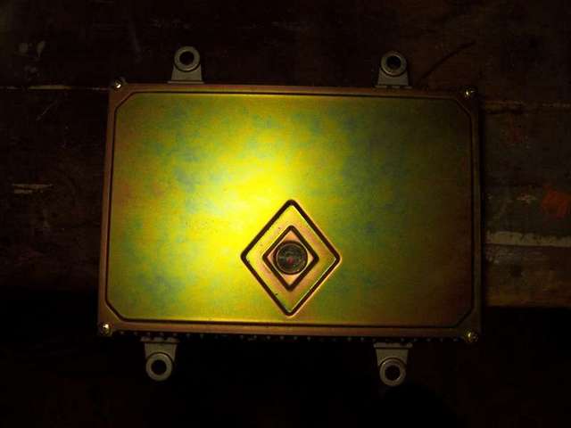

About 4 months ago at work a guy was working on a Honda which had a intermittent no-start condition. The guy who owned it tried to do the normal stuff, starter - battery - etc. But he couldn't figure it out. The engine was just replaced with a junk yarder - and after the guy installed it, the problem came about. Anyhow - after a few times of trying to get it to fail so we could test things, it finally did. Tested a few things and everything was good except a few grounds which were grounded through the computer. We replaced the computer and it started everytime. I, however, took the old computer since there wasn't a core on it. I believe it's out of an early 90's Honda Accord - but I can't remember exactly.
Here is the outside:
The little sight-glass is for when you do the little paperclip jumper and the codes blink at you. There is an LED inside there that blinks.
