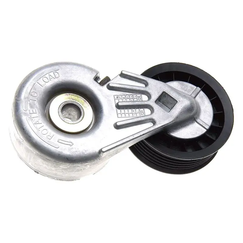

Remove the dad gum tensioner and it's easy access, but that's just my two cents. Breaker bar with a 16mm socket to move the tensioner, and a ratchet with a 17mm socket to remove the bolts. (Breaker bar is needed to gain access to the bottom bolt.)
Honestly it is the only way I do a thermostat job on these first gen trucks.
That's interesting -- what kind of tensioner do you have? The three different tensioners I have run have always needed a 3/8" square breaker bar to rotate them -- no socket needed.
The ones I have always used on the Ex look similar to this, with the square hole for a 3/8" breaker bar to rotate:
You have to take the belt off then the tensioner will spring down out of the way to get to the bolt.
