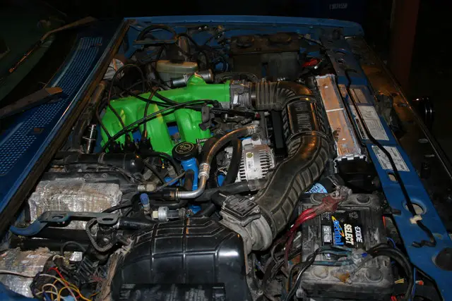

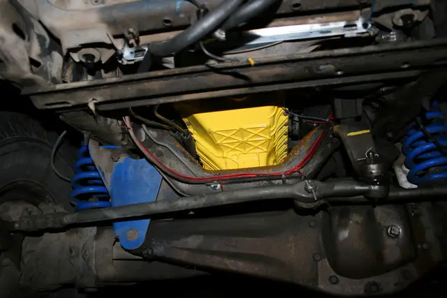

I got my clown motor built and it is running in the explorer..
Before I get to the pics.. Here are a few things I picked up using a 91 donor motor to rebuild and put into my '92

wow what purty colors :) do u have any pics of the engine an trans out of trk all hooked up ??
i cant tell from ur pic but are both ac lines running across front of engine ?? as im sure u know one line on a 1991 runs across tha back of the intake an then up to compressor did u make a custom hose or is that how a 92 routes the ac hose ??
Factory '92 a/c hose runs behind the engine. Many years ago I replaced the hose (it was leaking) and the new hose ran in front of the engine. I've been using that hose ever since.
Also, I didn't take the trans out of the truck, just the engine and part of the exhuast. I didn't take pic of the completed engine (with water pump etc). The closest I have are the pics in the first post with the engine on the engine stand which is almost completed (no water pump but just about everythign else is on)
