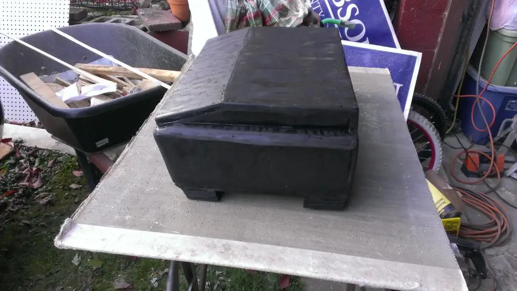

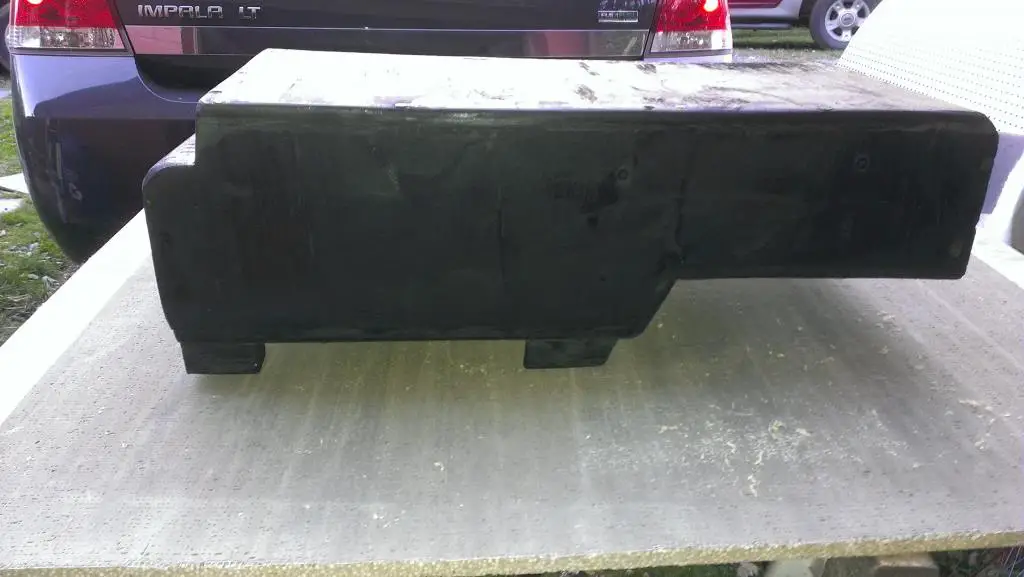

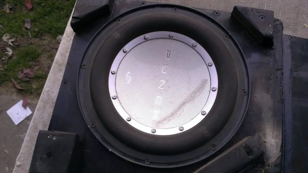

Ok, here are a few pics of the box:
I'll get dimensions figured out, and then post em up. I did have to hammer on the steel wire that holds the upholstery on the seat. If you bend that wire up, you can get close to 8" in height from the floor.
I have the speaker wired for a 2 Ohm impedance, which lets me use my amp for the full 300 watts it's rated at.
