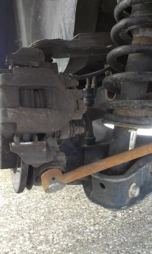

Hello!
I have what I hope is an easy fix (not sure why it started doing this though)
I have a Ford Explorer 2001 Limtied V8 AWD.

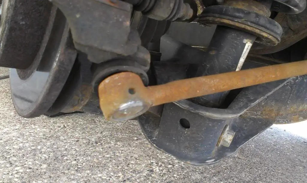

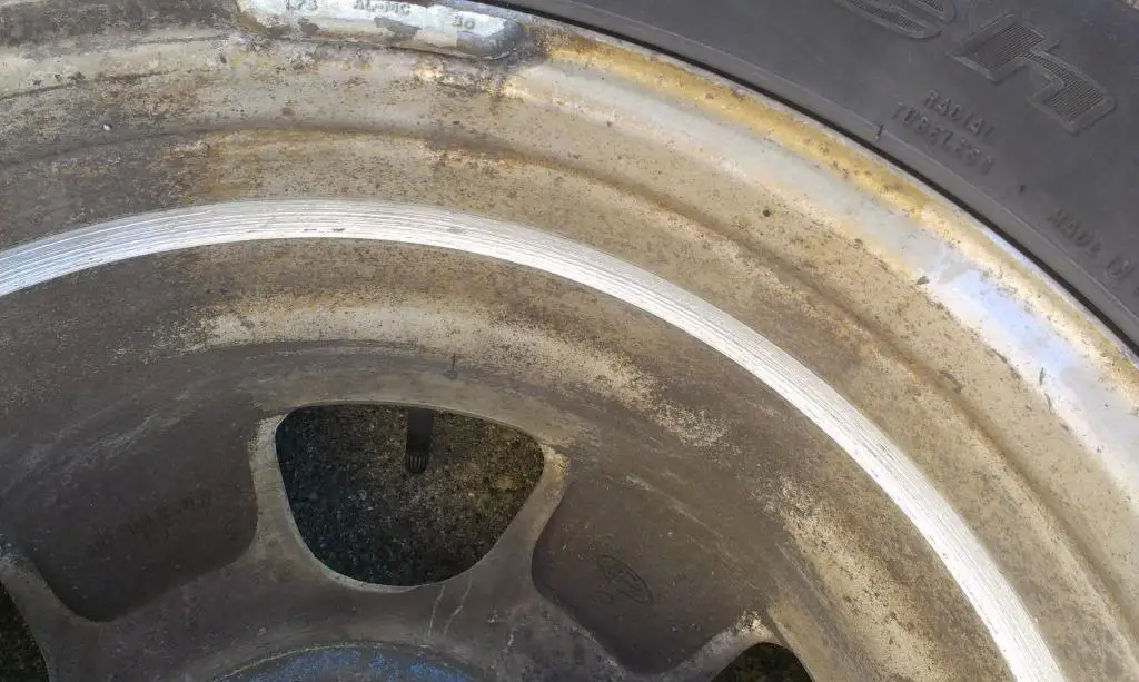

The toe link ( I think that is what it is called), driver side rear, has started rubbing against the wheel. IT started doing this about a week ago.
Is this something I can adjust? Or is this caused by a bigger problem?
It is winter here in the north and I might have hit a pothole at some point.
I forgot to mention: the Toe Link was replaced this last summer (July) as well as the wheel bearing

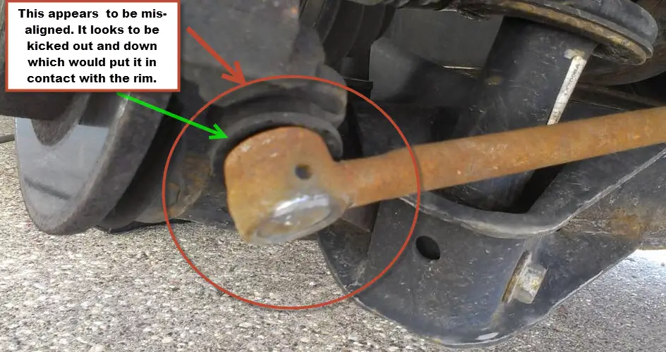

From what I can tell from the pic herein lies your problem.
When the rod was replaced perhaps the castle nut and cotter pin weren't tightened or installed correctly. It appears the rod end is not aligned correctly.
Thanks you albi1cnobi1. I will plan on taking it in on Monday then. I lack the tools to align it properly. When we changed it last summer, we used the old Toe Link to match the length, but it is possible that the new toe link was jsut slighty longer.

a final update:
The toe link was the wrong size. I used the 17mm problem solver by Moog. Mine was actually for the 15mm toe link.
The place I took it to, replaced the toe link and had the Explorer aligned for 211.00
Thanks to everyone here. I have been coming to this board for a long time! I learned how to replace my wheel bearings from you guys!
