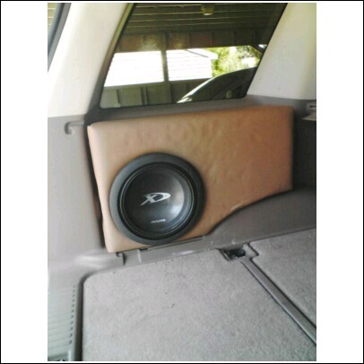

it cant hurt to try. maybe it wont look exactly the same, but im sure you can make it look good. i have made many boxes, but here is a pic of my first one that i made to look like it came in the truck. its not perfect, but it definitely looks better than a big box in the back.

yea ive built alot of boxes for myself and a few for my friends and most have came out pretty good so i may give it a shot. I mean never hurts to try right. Ive been thinking about giving fiberglass a shot too so this may be a good time to try it out.
one thing you can do as an alternative to fiberglassing that is quite a bit easier, but will still make it look like the plastic molding on the interior of a car is vinyl. on the box in my car, i wrapped it in .5" foam then in vinyl and besides the color being a little off, the texture is exactly the same. if i had an easier interior color to match, such as black, it would be perfect. also with the foam, all the corners and screw holes and all of that do not have to be perfect. just another idea for you to think about.
