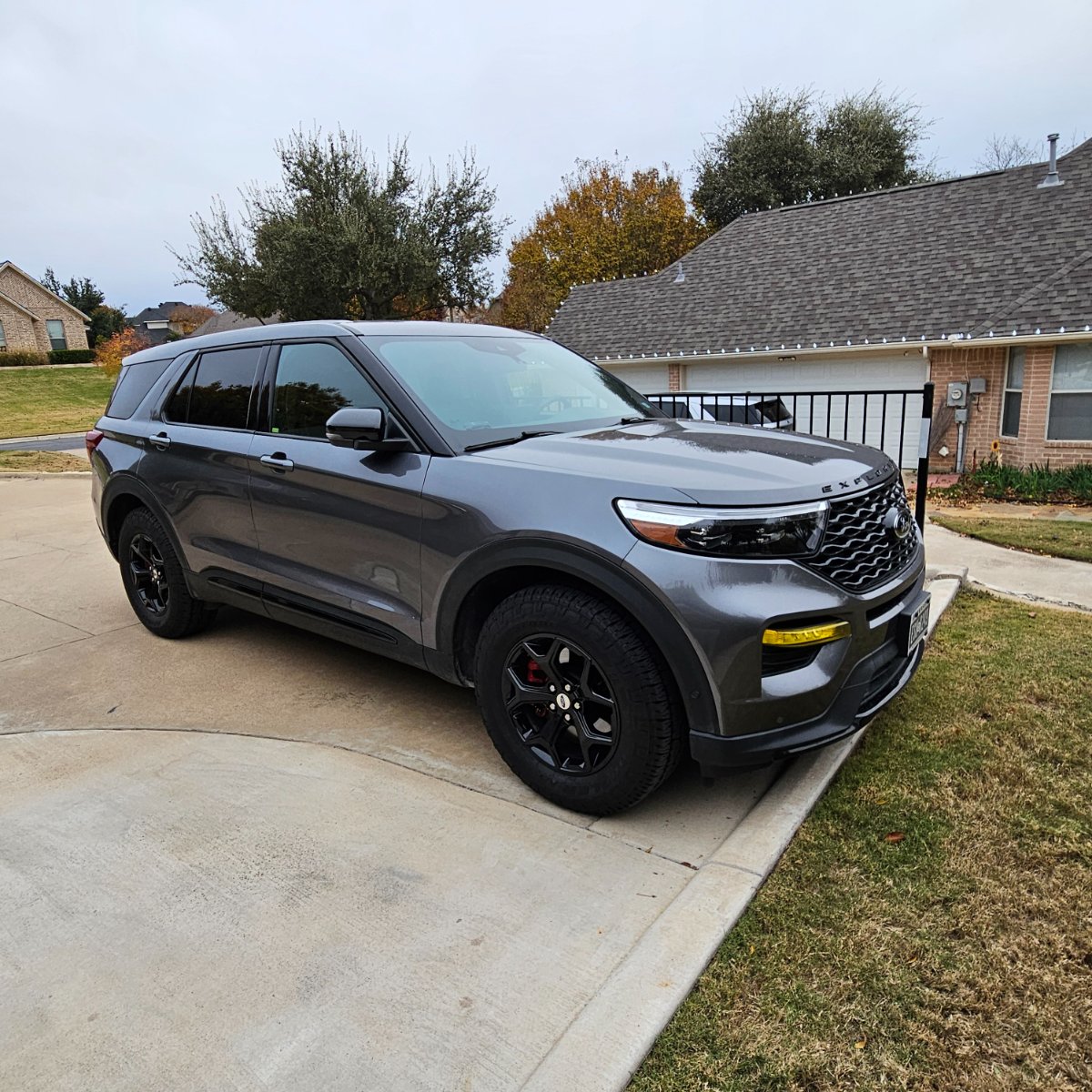

Found an almost unused set of Timberline wheels and tires for my 2022 ST. They fit perfectly and IMHO look great. Just in time for winter and an occasional off road venture.
Original tires were OEM Pirelli Scorpion Zero 275/45/21
New tires are Bridgestone Dueler 265/65/18
Do I need to adjust calibration for MPH or is it close enough? I've read here about the 3% variance but I can't figure out the math.

I use 255/65/18 which are 1.3% larger. 265/65/18 is 2.9% larger circumference than stock 21" tires.

It’s easy to do on Forscan, but not really needed. Not that big of a difference.
Thanks for doing the math ... it was over my head.
