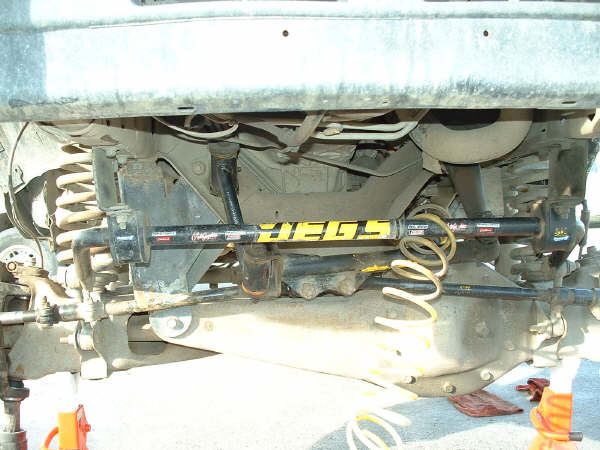

I've spent the day out under the front of my Ex and was wiping down the super runner steering for the Superlift and found a mess of performance stickers under the filth. I wiped down most of the lift stuff and found several more tiny stickers: Edelbrock, Performance cams, SK racing, Real Gear Racing etc.
I had been toying with the thought of repainting the lift parts including coils. What do you think?
I've seen several lift kits painted RFR22's red Skyjacker lift comes to mind. I know that Superlift used to make their lift parts yellow. I have a red strip in my molding so I was leaning towards that, but then my rear drums are painted blue along with my rear diff cover and wire looms in engine are blue. Then again I do have the coiled hoses exposed for my extended axle breathers and they are yellow.
I will try to take a pic later and post it. But let me know what color would look best. It will get painted I have decided just what color.

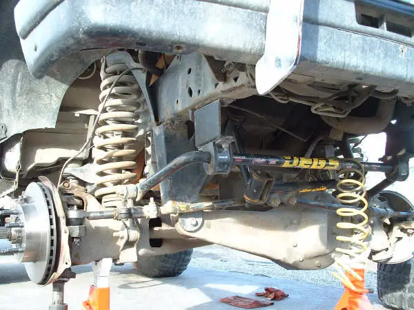

Oh I was going to add this pic. Its dirty but its just plain. Yours is clean and colorful.
Do you have D44 outers? Your rotors and spindles look different from mine for some reason, or maybe I'm just not remembering correctly?
It would be difficult to fit the steering staybalizer in there, if you saw where mine was mounted, it would have to pass over your idler arm, you could fab a longer mount, drop it lower, and attach from front of drag link, it will be tough, the drag link just isn't long enough, or mount it to the inside behind the idler arm? I went thru that on a mazda, it took a while to figure where to mount:confused: , when I had the three inch coils they were superlift, scratched and painted partial black, I bought them used, and painted red, cheap walmart red works good, I already had the day stars installed, that's where the red bushings came from. As far as decals, it's up to you, I am conservative on that issue, the only ones I have are a white skyjacker, and white serious explorations on my rear hatch, and flexplorers decals on the side windows, also daystar warning in between the visors inside, hey theres nothing wrong with flaunting what you got.
Not as far as I know. All the parts I ordered for the repairs recently were for a D35. That included a used steering knuckle, new rotor, bearings races, outer tie rod and ball joints.
But I've never seen the D44 TTB stuff.

I'd say red, but all my stuff came red. I'm glad to see your explorer is working well for you. I like your new rotors. Very sweet.
Also looks like your sway bar would hit your steering link if you got off camber a little. Maybe you should get the skyjacker extended sway arms, or maybe some jeep quick disco's and raise that sway bar up some. Get rid of that cheapo drop braket too. Just my $0.02 worth though.

Yep actually my steering has been wearing on the sway bar link. There is a nice groove wore in it. I also noticed that the steering has been rubbing on the axle drop bracket.
So which drop bracket are you suggesting replacing? The one on the swaybar or the axle?
