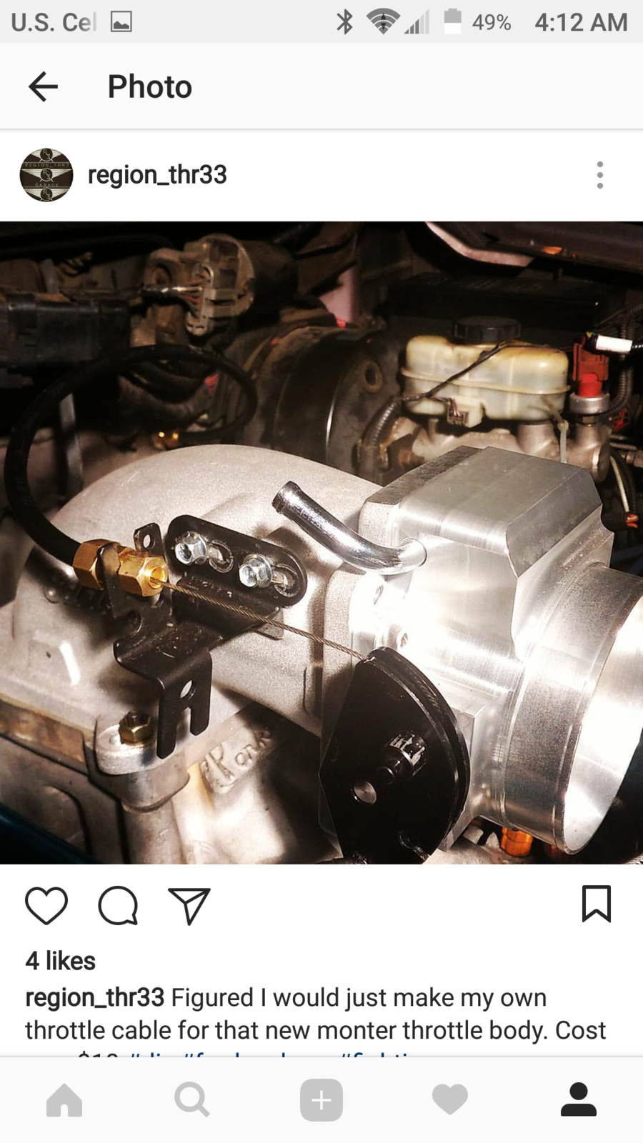

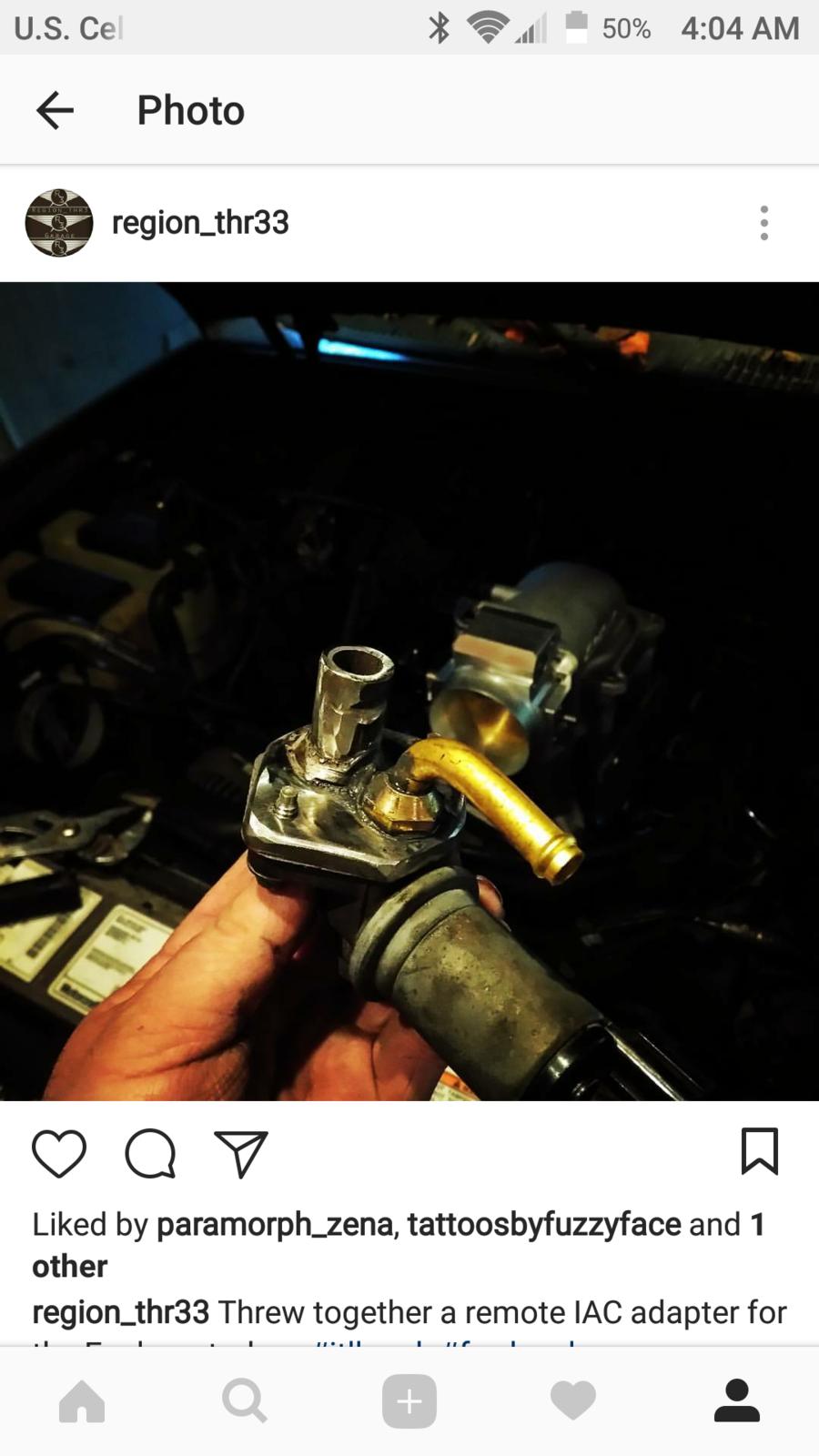

How did you modify the cruise and throttle cables? your using a GM tps that came with the throttle body? I'm guessing you used a elbow made for the lsx so you didn't have to make an adapter plate? How about dealing with the iac valve? I see it in the pictures, but can't see how you dealt with it.

Thanks alot. I actually used the stock throttle cable (the cable itself). I replaced the outside covering with some air line and used compression fittings on the ends(firewall and cable bracket). I am using a GM tps. It's 3 wires just like the Ford unit. Just matched up some schematics and wired it up. I did have to clock it to get the voltage where it should be. The stock gm IAC can't really be wired up so I used the stock Explorer IAC. I just welded up an "adapter" to make it remote mount. Works the same way as stock. Pulls air into the intake from before the throttle plate.
Air in, air out. Remote mount IAC.
Throttle cable. The stock unit was too long and wouldn't work with the TB so I shortend the stock inner cable and just replaced the outer tubing with air line. Used a compression fitting on both ends. Did the same on the cruise control cable.
MMR sells a remote iac plate. Also I think the 4v 5.4 Navigator has a remote mounted iac factory.
