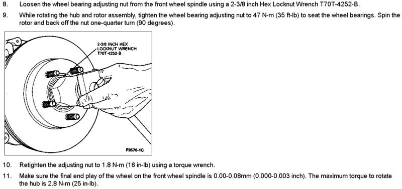

i would say either you didnt really tighten them well the first time, or you got them tightish, and then running it fully seated the bearings and they got loose.
See attached image; found this in the Ford service manual under the automatic hubs section, but should apply to manual hubs too since bearings are the same. Notice it mentions a more detailed bearing seating procedure, an end play specification, and a final specification of maximum torque required to spin the rotor (bearing drag only, without brake caliper installed).

Great! Thanks. I don't have a torque wrench but I imagine it is about time to get one so I can be sure to adequately seat the bearings and tighten the wheel. I have read a lot of posts dancing around the manual's instructions. The sticky on this site about how to change rotors on this truck is the one I followed step by step in the first place. It was a huge help.
Make sure you use two separate torque wrenches for your general car jobs. Note that in the illustration I posted there are specs in ft-lb and also in-lb measurements. In my garage the 1/2" drive very large torque wrench works well for 50-150 ft-lb items, like lug nuts, and a smaller 3/8" drive torque wrench for everything measured in in-lb and under 50 ft-lb. Didn't spend a whole lot on either unit.
Yeah I picked both up yesterday. The in./lb wrench was a bit difficult to use with it being so low and also using that massive 2-3/8 socket. However, I finished the job, thanks to you guys and that other thread in this forum, and it seems to be just fine. I did get a little smell when I put some serious heat into the new brakes for the first time, but I figured it was the rotors and pads hitting a certain temp. because it only happened when I braked for a significantly long time down a 9% grade...
