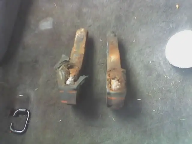

Well, i did manage to get the t-bar adjusters replaced on Saturday. QUITE a difference.
Here are the old ones:
Instead of using a puller, which Autozone did not have in stock, i seperated the knuckle from the upper balljoint and removed the lower bolts from the shock. This allowed the control arm to drop and removed all of the tension from the torsion bar (a process i read elsewhere here at EF).
The total job took 2.5 hours, 1 of which was spent grinding off a couple bolt heads from the adjuster protective cover - no air tools, so i used a rotozip with a metal cutting/grinding disc - what a b!tch.
The hardest part was getting the adjuster to twist just enough to get the rectangular adjuster "key" back into the opening. Having a puller would have made this easier, but once i figured it out on the driver side (i lowered the truck down (stock jack) and used the jackstand to align the adjuster) the passenger side took only 30 minutes.
I thought the Edelbrock shocks i purchased a while back were just plain crap, but new adjusters brought out the best in them. The clunking is almost totally gone, although i did notice that my left-upper BJ is shot and in need of replacement. This leaves only, ummmm, 10 things on the to-do list.
