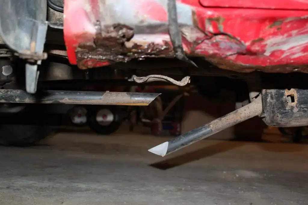

fyi: not all torsion bars are the same… different part numbers… different specs…
