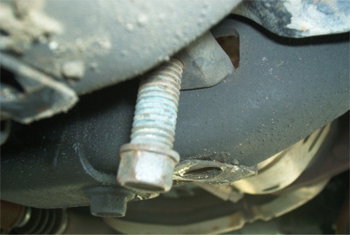

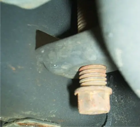

I was under my truck today tinkering around with the torsion bars, and I found that the bolt on one side is screwed in more than the other side. Pics will explain it better.
Left side:

Notice how the right side is turned in more than the left side:
Should I be worried about this?

no i believe that is normal, if you try to even out the bolts it will just make your explorer lopsided

i think i have the answer to your question, check out this quote from a post by GJarrett :
A side issue I had to deal with while doing the torsion/Warrior lift was the fact that I couldn't crank my left torsion bar up very much: I couldn't even get an inch of lift. Upon cleaning up the front of my torsion bars I noticed that they are stamped with their identity; ie, the right one was stamped "BR" for "B" rated right hand torsion bar. I noticed by the stamping that the left one was one-sixth turn off as installed from the factory! I had to remove it, turn it one-sixth turn to its proper alignment, and reinstall it before twisting it up further for the lift. The bar is removed by completely removing the adjusting bolt that is used to do the twist, and then using a special Ford tool designed specifically for the sole purpose of releasing the static pressure on the bar's arm to enable removing the torsion bar. I used a gear puller instead and avoided having to buy the tool. If you must remove your bar you will realize by sight what you need to do once you begin the job. It was an extremely difficult job using the gear puller I had, but I believe a different gear puller or the special Ford tool would have made it a fairly easy job to do.
here's a link to the full post, GJarrett has a sweet EX.
Full Post
my adjuster bolts were in nearly identical positions as yours. with my bolts completely removed it sits 2 1/2" lower on the driver's side and @2 1/4" on the pass. side.
