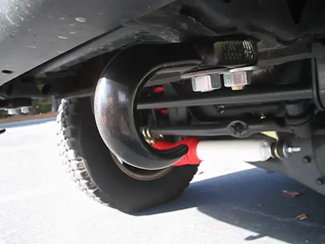

Here's a pic of mine. You can use a hole in the frame for one of the bolts, and then drill the second one. Hope this helps :)

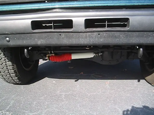

well I did mount it to the push bar and it works well. I mounted them approx 2 inches from the frame for the strongest point on the bar. I used it to pull my friends 2002 tacoma uphill for about one city block at about a 25-30 degree slope with no problems not so much as a hairline movement in both the hooks or the push bar. heres some pics...
That looks good, but I have a feeling somebody will say its not strong enough.
Those aren't gonna be strong enough
j/k :D, looks good.
lol thanks well i know there pretty stong to pull a 2001 4 door tacoma up hill in reverse with ease.
Static pulling is one thing, getting jerked out of a mudhole is a whole different thing. If they will only be used for light duty use, you should be fine. I think that a hard pull will bend your pushbar, but I may be wrong.
At least you have a decent frame mounted push bar. It looks ok for light duty use, but I would be very careful when using it. The Straight line pull you did was one thing, but often times the pull is off center and could cause your push bar to wrack under the force. BTW what grade allen bolts did you install?
Stainless Allen Bolts are only grade 3 to 5. Regular Allen Bolts are Grade 8. You can't harden Stainless Bolts they are made out of 300 Series SS. Regular's are made from high carbon steel and are Hardened.
