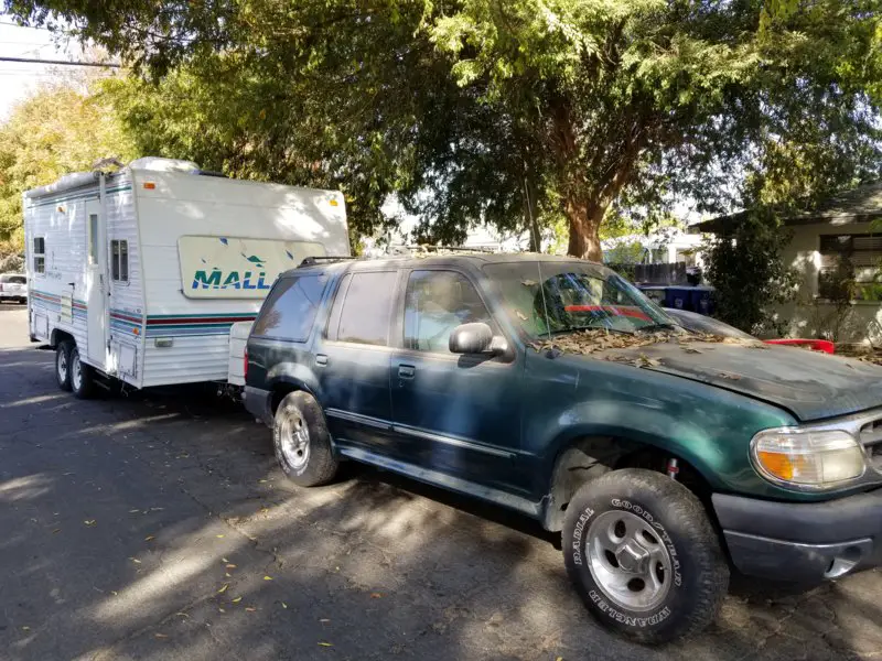

The picture below is the animals and myself camped out in Pacific Grove next to Asilomar State Park Conference Center on a side street. And wouldn't you know it, someone parks directly in front of the GMC....the whole street was empty and they park near my Suburban. I guess for safety, sorta like a small kitten who snuggles up next to the momma cat.
I just returned home from a 400-mile trip towing the Mallard. The 99 Exploder did just fine.
