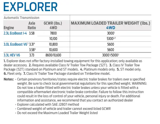

Looking to purchase my 5th Explorer. Looking at a 2022 XLT with the 2.3 Eco at the moment. I do have a boat that weighs around 3500 lbs with trailer. Philosophically I have an issue with towing something that large long distances. Any feedback good or bad truly appreciated. Thanks

With the vehicle you mentioned, #2 would apply and that is if it was factory installed.
