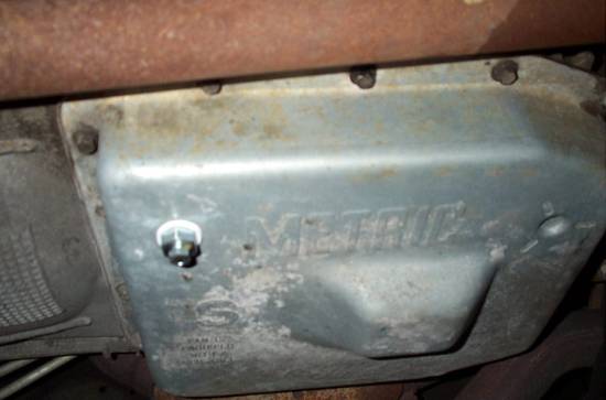

I got a drain plug for the trans pan so that next year it wont be near as messy.
