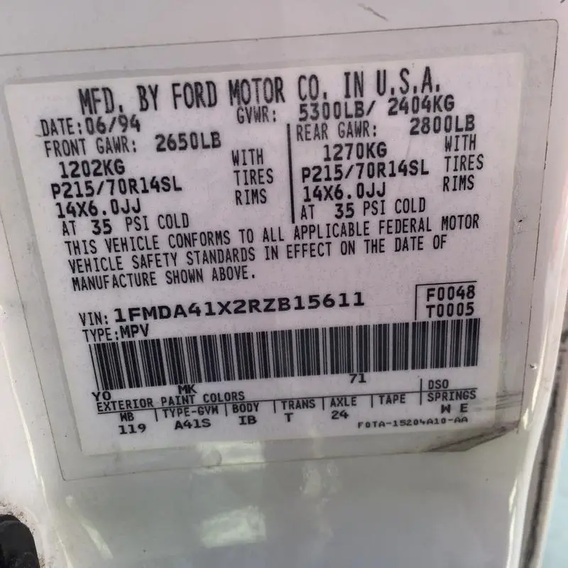

I found a link to change an explorer t case fluid. They said removed balancer and it should take just over 2 qt. is the Aerostar t case basically the same balancer 2 qt and drain plug behind balancer. The old owner told me when I bought it she had the plug fixed 3 times fluid leaks from the plug. On an older write up there was mention of a mandatory t case replacement because they were made out of magnesium and cracked like an egg. And also an extra brace was placed on the t case to trans mount tail to take some of the force. If my case needs to be replaced should I get a 2 speed bronco 2 manual case so my front diff stops spinning. Or do I use explorer 2 speed manual I don't want to wire up a electronic eawd explorer unit. I'm draining my fluid tomorrow and inspection will follow
