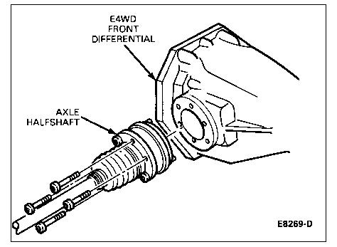

I looked at my Ford software. The transfer case doesn't have CV axles pressed into it. It has half shafts which are bolted to the front differential. No slap hammer is required. You will need a front hub press to push the CV out of the hub. Don't use a hammer on it.

That's good to know. I thought you were referring to the slide hammer was needed for removing the flanges. I was thinking I had ordered the wrong kit.

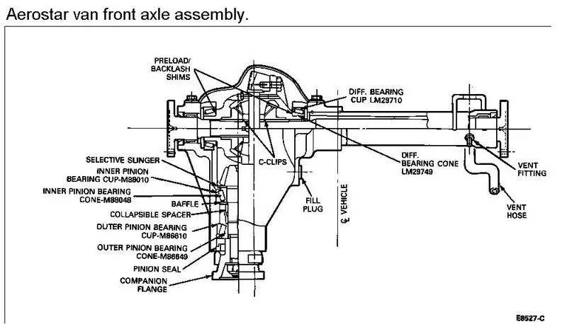

I'm still wondering about the flange that comes out of the front differential. I need to replace those seals. How are the flanges removed? I've worked on VWs before that were spring loaded. Without the right tools they were impossible to get back in.

This diagram from my Ford software is the front axle assembly. It shows that it has internal C clips to connect the front flanges.

Oh geez. I was thinking it was a transaxle, not a differential.
Thanks for setting me straight.
