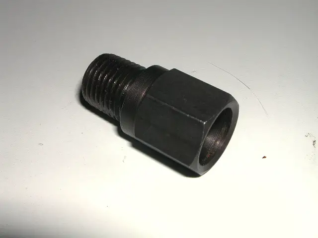

I had just replaced a radiator in a 93 Sable, and was relying on that to make my reply above. When I got home, I looked at my 92, and sure enough, same same. To help here's a picture.... the end cap on the radiator (the thing all this is screwed into), IS plastic. there is a place the thing I referred to as a "bushing" gets screwed into.... then the line fitting screws into that... here is a pic of an extra bushing from the Sable job I recently did... this is what can be held still while the line fitting it loosened..
here is the actual fitting in my 1992 Explorer
ALl of this assumes that your 91 is the same as my 92, which i *THINK* it is. If I am correct, then it would seem to me that if you used the proper wrench (called a flare nut wrench) on that big fitting, it should be easy to put a lot of torque on the nut holding the line into it (using a second, and smaller flare nut wrench), without bending ANYTHING. I always hate to overcall someone else's work when I am not there, but this one has me mystified. Go somewhere else.
