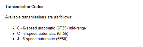

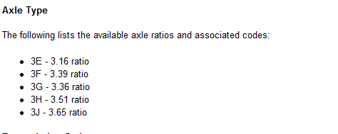

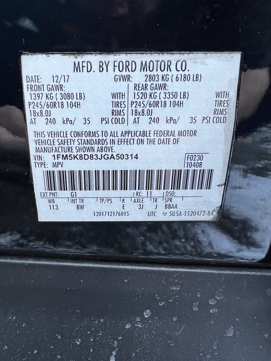

Hello guys! Looking into a small travel trailer and trying to see what I can tow. Went into the towing rabbit hole for like 2 weeks. I believe I have a 6f55 transmission with a 3.65 ratio. Tried like hell to go through the ford towing guide I downloaded from my fords website. Attached is a pic of the door tag.

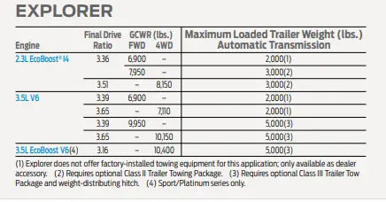

With the factory installed tow package you could tow 5000 lbs but with an aftermarket install you are legally limited to 2000 lbs. I believe the towing specifications mentions that and it has also been mentioned in this forum many times. See note #3 in the diagram I posted above. The factory package includes a bigger radiator and a different transmission, 6F55. Without the factory tow package, the Explorer comes with the 6F50.
