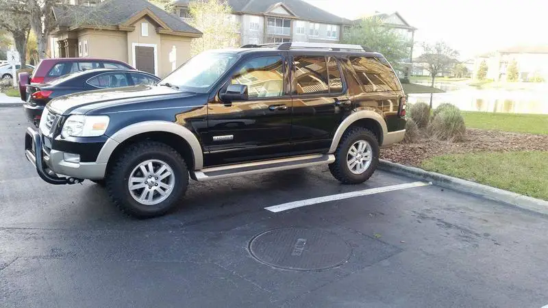

It took about a month to get the BTF upper control arms. I had them put on and my mechanic said they were worth every penny. No contact with the strut now at full extension - but we barely got the alignment done with the standard 3/8" extend. I downsized from 265/65-18 to 265/60s to give me enough drop to tow behind the motor home (using a 6" riser). I'm running 8.5" rims and not sure what the offset is. Those uniball replacements are fantastic. I just finished the last project for awhile - Wireless ebay backup camera for 35 bucks. Great pics during the day but I get some monitor flashing at night - so I will shift the power feed up front to the reversing lights circuit too. You can barely see the blue ox baseplate in the lower grill section - that point is 27" off the ground.
It took about a month to get the BTF upper control arms. I had them put on and my mechanic said they were worth every penny. No contact with the strut now at full extension - but we barely got the alignment done with the standard 3/8" extend. I downsized from 265/65-18 to 265/60s to give me enough drop to tow behind the motor home (using a 6" riser). I'm running 8.5" rims and not sure what the offset is. Those uniball replacements are fantastic. I just finished the last project for awhile - Wireless ebay backup camera for 35 bucks. Great pics during the day but I get some monitor flashing at night - so I will shift the power feed up front to the reversing lights circuit too. You can barely see the blue ox baseplate in the lower grill section - that point is 27" off the ground.View attachment 96295 View attachment 96296

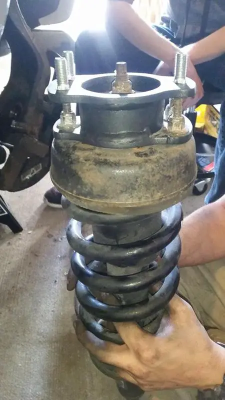

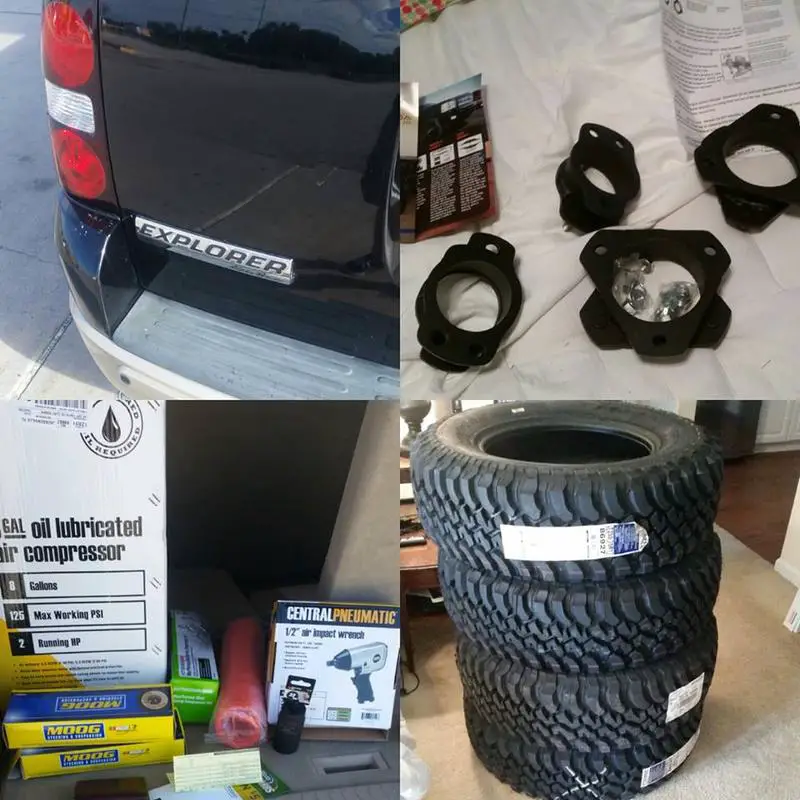

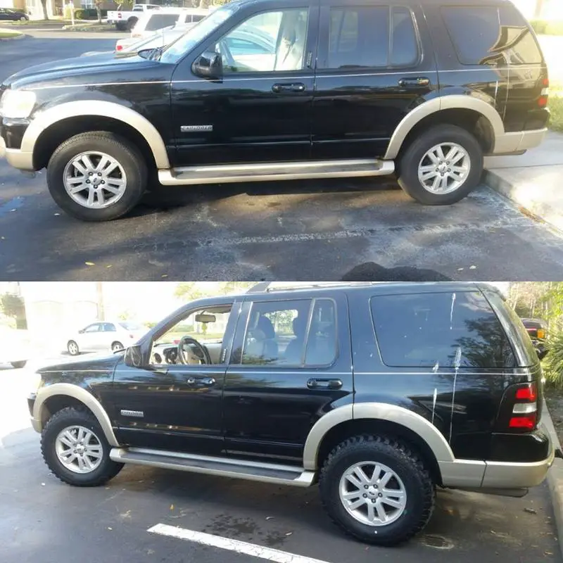

A little over a week ago I finally collected all the supplies, and had the time to build onto my 06' Eddie Bauer with the Traxda Level Kit. Now, before anyone asks if it was by the book? No. Not even close. It was done at a buddy's house and only jacks were used (which made it a complete headache) We just ended up taking apart the whole front suspension just to make it quicker, and TRUST ME. It made it a lot faster rather than fighting parts hanging everywhere. While we were down there we went ahead and just replaced the bushing/sway bar links because there was a little squeaking (now there isn't!). Overall it's basically a strut replacement job considering you're only adding a spacer to the strut itself (I kept my stock struts for the time being). Not going to go into detail about what all we did and how it was finished. If you have questions fire away though. I'm here to help! ( ALL PICTURES ATTACHED AT BOTTOM, COMPUTER IS BEING DUMB)
Big thanks to [MENTION=260174]engineeering[/MENTION] for all the advice.
Links to all the supplies needed!
Traxda Leveling Kit- Traxda Traxda Leveling and Lift kits, Made in the USA!
BFGoodrich Mud-Terrains-http://www.tirerack.com/tires/tires...QR7MTAKM&vehicleSearch=false&fromCompare1=yes
Aries Bull Bar-http://www.carparts.com/details/Ari...6ooyBMwhewAQDxEEacWEgfYaAjYS8P8HAQ&redirect=1
Aries Tail Light Guards-2006-2010 FORD EXPLORER TAILLIGHT GUARD PROTECTORS BLACK POWDER COAT (NEW SET) | eBay
