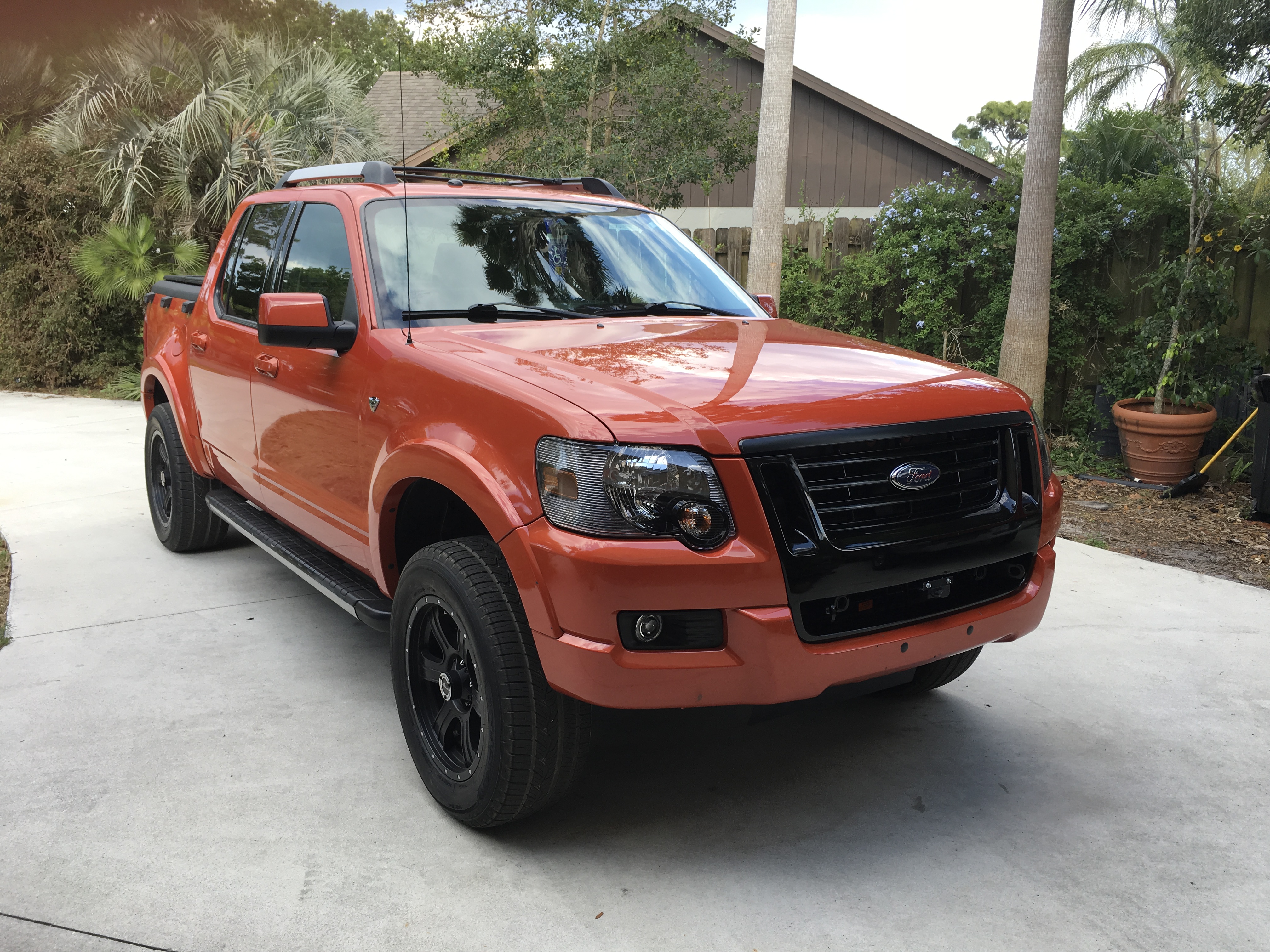

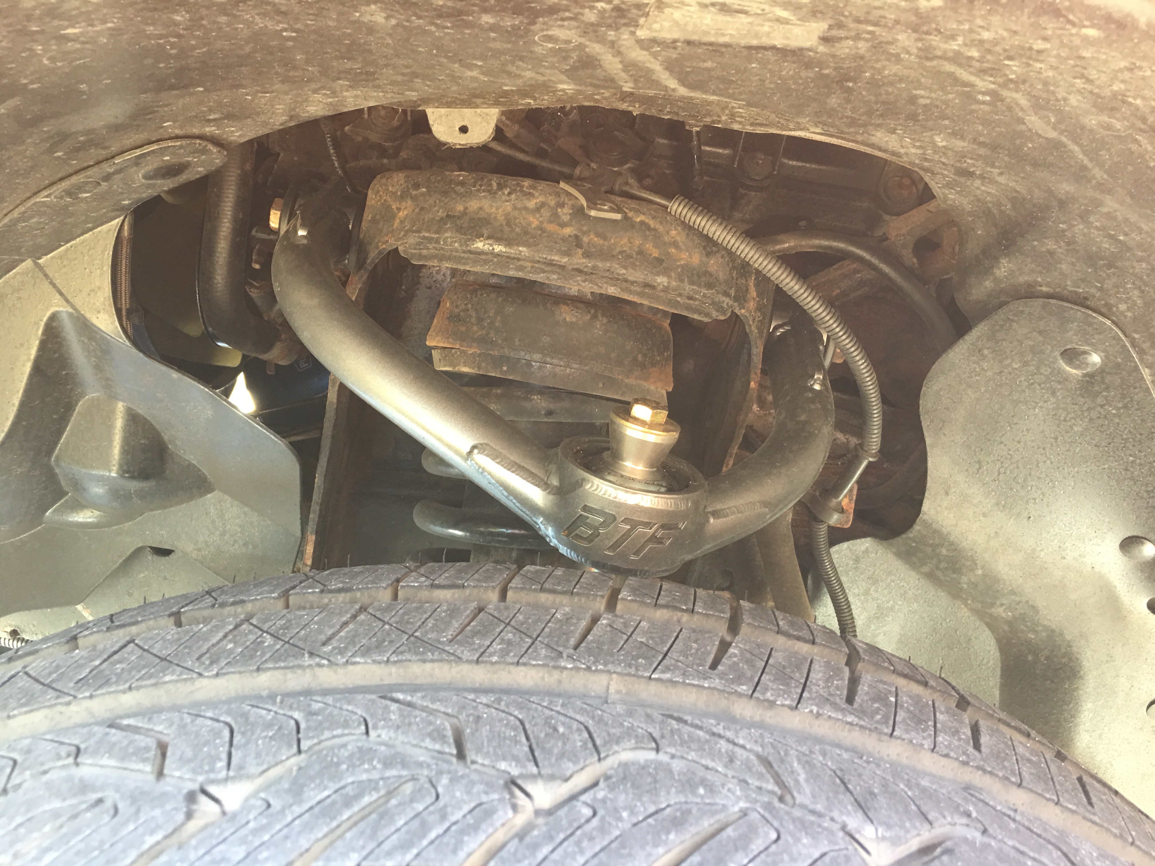

It took about a month to get the BTF upper control arms. I had them put on and my mechanic said they were worth every penny. No contact with the strut now at full extension - but we barely got the alignment done with the standard 3/8" extend. I downsized from 265/65-18 to 265/60s to give me enough drop to tow behind the motor home (using a 6" riser). I'm running 8.5" rims and not sure what the offset is. Those uniball replacements are fantastic. I just finished the last project for awhile - Wireless ebay backup camera for 35 bucks. Great pics during the day but I get some monitor flashing at night - so I will shift the power feed up front to the reversing lights circuit too. You can barely see the blue ox baseplate in the lower grill section - that point is 27" off the ground.
It took about a month to get the BTF upper control arms. I had them put on and my mechanic said they were worth every penny. No contact with the strut now at full extension - but we barely got the alignment done with the standard 3/8" extend. I downsized from 265/65-18 to 265/60s to give me enough drop to tow behind the motor home (using a 6" riser). I'm running 8.5" rims and not sure what the offset is. Those uniball replacements are fantastic. I just finished the last project for awhile - Wireless ebay backup camera for 35 bucks. Great pics during the day but I get some monitor flashing at night - so I will shift the power feed up front to the reversing lights circuit too. You can barely see the blue ox baseplate in the lower grill section - that point is 27" off the ground.View attachment 96295 View attachment 96296
That looks really good man ! I'm still waiting to order the control arms. Little pricey for what I can afford right now, one day though! You have a beautiful colored truck as Well!

I know I’m late on this question, but do you have any issues woth your upper control arms?
Yep. Lil hard on the upper ball joint... And your CV is under a bit more stress. But looks way better. So I would rather just swap out these pieces when needed (so far 1 upper ball joint and one CV but may not be related... 70k kms later). Kinda like spacers... Look better... but don't complain when your bearing needs replacement prematurely.
Cheers
So, we're going on year 3 with them on. So far it's destroyed my joints. I replaced my ball joints out for BTF uppers and uniballs. Rear CV and Diff needs replaced (doubt they're actually related, more a problem from heavy wheels and tires.) but front end is still giving me issues. Front hubs, and steering rack are on lists of immediates.
