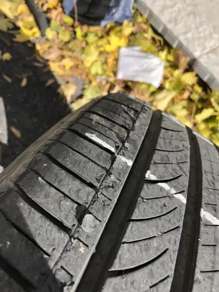

Hello,
I live in Canada. This past weekend, I removed the Hankook tires from my 2017 Ford Explorer XLT Appearance Package to install my Michelin winters and noticed the severe flaking/chipping on my front two tires. They'd been rotated when installed at the beginning of summer 2018. I have two kids and believe I drive my Explorer probably more than responsibly. The SUV has ~28,000kms on it in a year and a half, but I'd estimate the Hankooks have approximately 15,000kms on them. I took pictures and reported to my dealer. They've have asked to see the tires when I bring the vehicle in next. I won't accept having these tires reinstalled on my family vehicle next summer. I also submitted an online defect complaint to the recall division of Transport Canada. They responded immediately and asked to come pick up the tires today for inspection/review. Will let you know what comes of it.
Hello,
Please keep us posted, as mine has also worn out quicker than normal, despite swapping them out during the winter.
I recently rolled over 60K km (average of 20K km a year) and if you divide that by two for the winter season, that's about 30K km on the tires.
While mine hasn't flaked our showed any other signs of defects, it is definitely abnormal wear, compared to the tires on my other vehicles.
