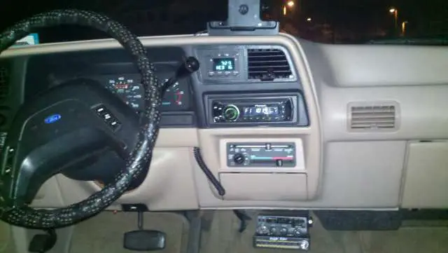

So since i'm back with a 1st gen (again), I missed my 2nd gen message center I installed a few years ago. After getting the itch again, I got everything ready to do a 2nd gen -> 1st gen message center install...
In talking with Russ (Nice59), he mentioned something about a Trip Minder message center used in 85/86 Cougars/Tbirds. When I saw this I got uber excited as it had more features then the 2nd gen MC, was smaller AND was super 80s! I had to have it...
So fast forward a few weeks, I was able to pick up a brand new TripMinder from a guy off of the Cougar forums. Fast forward after a few hours of cutting/waiting and cussing, we have success!

I love how the install came out, looks like it belonged there from the factory. I had to relocate the 4x4 switch to my overhead console, and for some reason pushing buttons in the ceiling is 10x more fun then on the dash.
Crappy night pics away!!

Thanks guys! I'll post some more pics of the install later tonight...it's fairly simple. I'd rate it a 2 out of 10 on my psuedo scale of difficulty.
The biggest issue was waiting for my friggin Dremel to recharge cuz there is a ton of cutting and reshaping to do, and i'm lazy when it comes to plugging it in.
Also waiting for the glue to dry...one of those always waiting projects!
Still looks pretty dang good! Have any trouble installing that pin 34 pk/lb wire on the pcm? And does that tripminder tie into the tach signal at all?
Word! It was pretty simple since the PCM is so easy to get too, just had to borrow *cough* a PCM pin connector from the JY. It doesnt use a tach wire, just the VSS on pin 3 to calc speed. So after power/illum and ground wires, its techincally just a 2 wire install :p:

this Link tells about the trip minder itself and how to install it in a cougar or thunderbird....BUT with the right wiring diagrams, these will install into any ford vehicle that is EEC-IV, and I am willing to bet EEC-IV as well. Ill let LiKuiD go into detail since it is his install afterall, but you want to get as much of the pigtail and wiring as possible for this, just to make things simpler.
Hmm so slight issue, apparently I get 160MPG on the highway!
Looks like my signal for the DOL isnt coming through right...trying to figure out what can be wrong but theres only 1 possible choice...*scratches head*
Possibly a semi damaged TP? Will post back after more testing...
