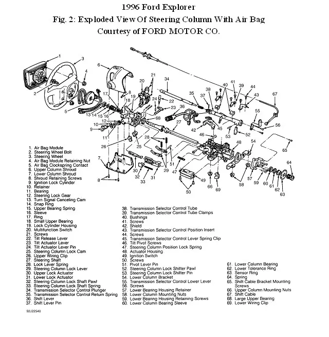

Would anyone have a diagram of the locking mechanism for the steering wheel and/or suggestions on how this could interact with the starter not engaging? I feel sure these two are connected in some way.

Just to follow up on this problem it was the ignition key lock switch. When I removed the old one you could see the grooved end was a bit chewed up and worn. Strange that the old one operated smoothly though. New key lock fixed it.
Thanks,
Andy
Also I do have a exploded diagram of the steering column if someone needs it. I cannot post it but will email to someone that can.
Not real neat but here it is.
