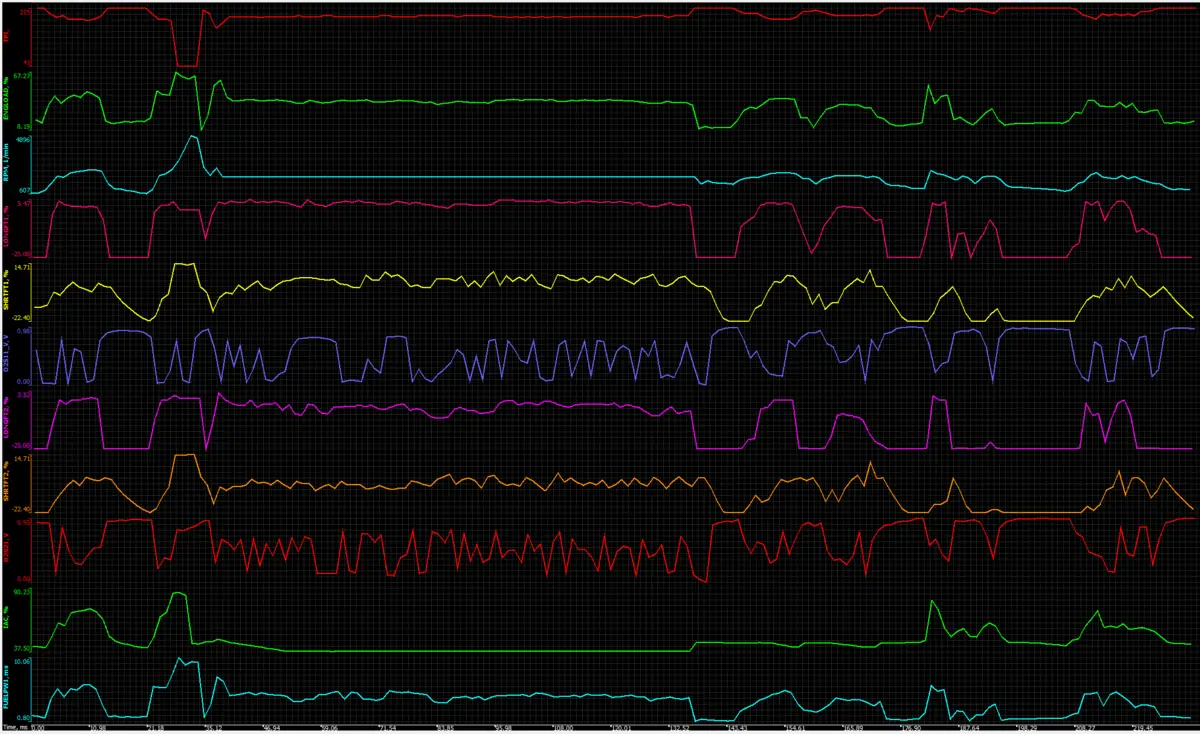

On this you can see:
1-20: Softly accelerating, then coasting down a neighborhood road.
20-30: Hitting the throttle while pulling out onto a 50 MPH road.
30-137: Dropping into and riding in cruise control @50 MPH
137-230: manually driving behind another car at about 45 MPH.
Next time I will add speed as well. Down the left we have Throttle, Engine Load, RPMs, Long FT1, Short FT1, O2 bank 1 Front, Long FT2, Short FT2, O2 Bank 2 Front, Idle Air Control, Fuel PWM bank 1
From my inexperienced look, it seems when engine load is above ~25% its running fine, its just when it's below that that there is issues.
