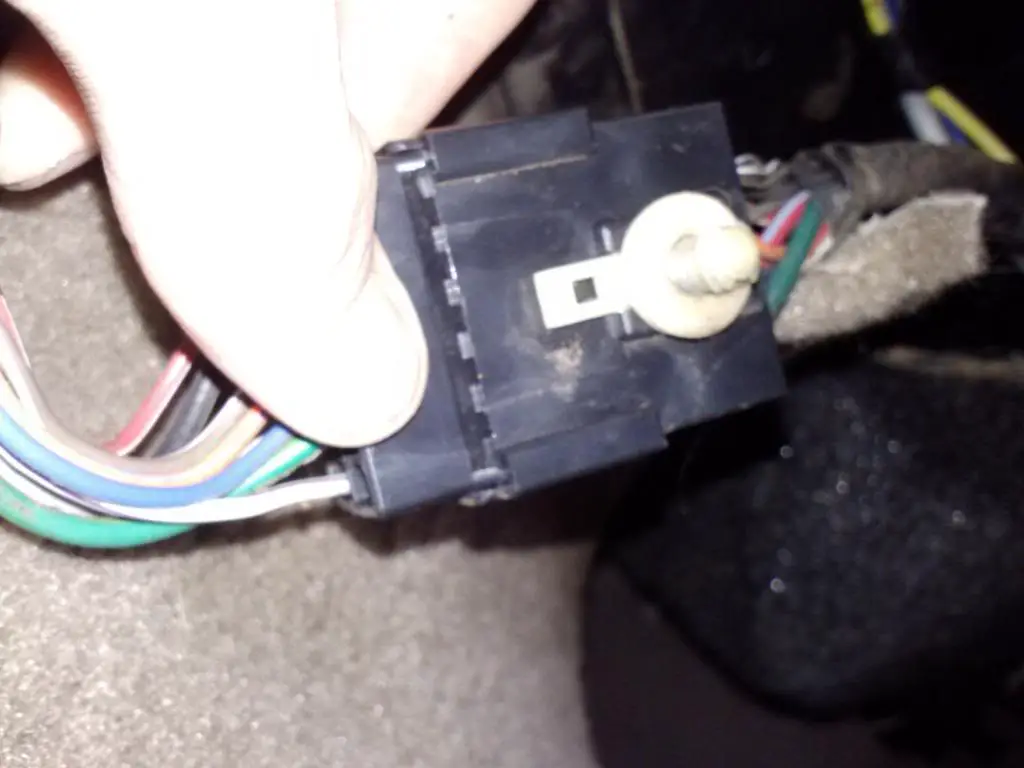

YES VICTORY!! I found the wire was blown up (Bulged really bad) by the back of the drivers door! So I cut that part out and just stuck it back together and 4x4 is working!
