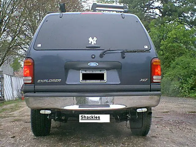

i dont mean to intrude on someone else's thread, but i was wondering about the rear leaf springs on the four door x. i have custom exhaust that exits similiar the way stock does on the passenger side on the driver side (pipe some between the frame and the leaf spring. are shackles the part of the suspenion that bolt to the frame and then to the leaf spring? if so are the warrior shackles what i would need to lift the back end on the x up a little. the only reason i ask is that most people that ride in the x (4 adults) are all home grown (NOT skinny). i'm sorry to ask a dumb question. i'm not familiar with suspenion upgrades, mostly a little knowledge about most other things on cars/trucks.

yes shackles are the part the is on the frame that the leaf springs go into.. i will take some pics when i get home..

BTW To answer williecume's question i attached a pic... those are the shackles... yours are a lot smaller... but in the same place..
