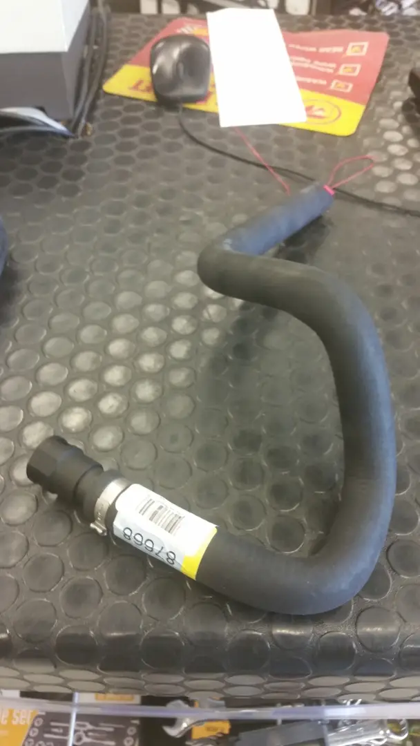

2) replacing hoses (upper and lower radiator etc). The two hoses from the heater core on the 5.0 there's not much info in Haynes or what to do. Think from searching one is supply and one is return. On the autoparts stores I've checked I cannot figure out what part it is, on advanceauto the only thing that shows in their system is "heater hose" for the 5.0, doesn't say supply, or return, and the lines look kinda different from the one in their system. Here's what they show http://shop.advanceautoparts.com/p/carquest-by-dayco-molded-heater-hose-87668/19590309-P?searchTerm=heater+hose . Is that it? Does two of those replace the factory ones, b/c they twist in such an awkward angle on the V8 vs the 6's that are straight out and easy.

So went to the parts store to check it and compare, the heater hose listed in the system is nothing like the ones on the 5.0 trucks. Went out to compare, the bends and form are completely different, you couldn't even trim or bend it to fit as that would cause it to kink like I tried. The hoses on these trucks are really more like S curves. Checked some other hoses, nada, no way to trim or bend any to fit, it's such a super tight space.

This is the incorrect one parts stores carry
