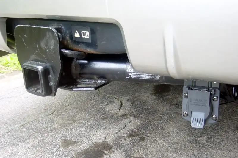

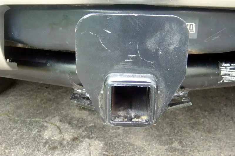

I found a class 3 receiver from u haul. Part number 78242,,,(75132 wont match up with an 02 6cly AWD)
UH didnt have the hitch in stock and found one in MA at another UH and was going to have it shipped to my local NY UH. I called for a tracking number and it was never shipped. I told them to ship it overnite at their charge and they did.
I previously installed the plug and was set with that,,, write up to come
Heres the install

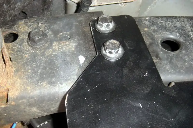

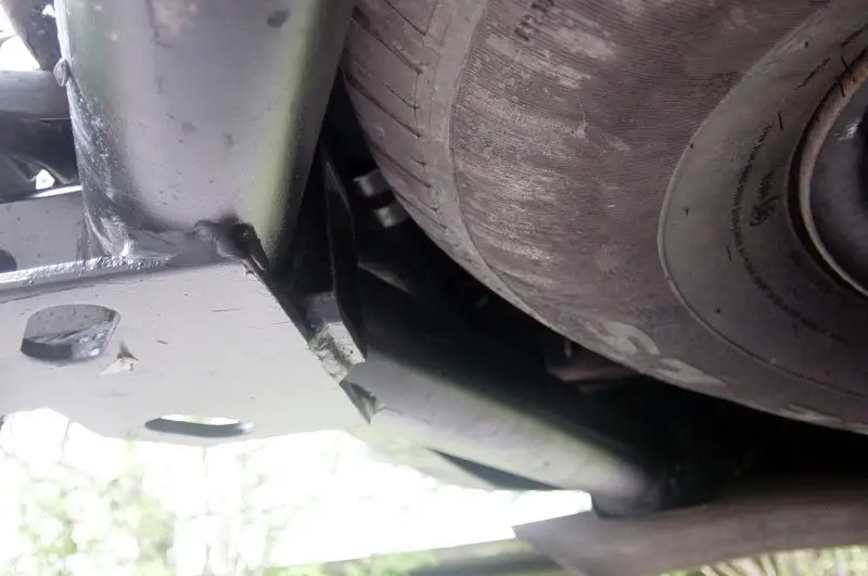

THese 2 bolts had to be removed from the stock hitch on both sides
And re installed

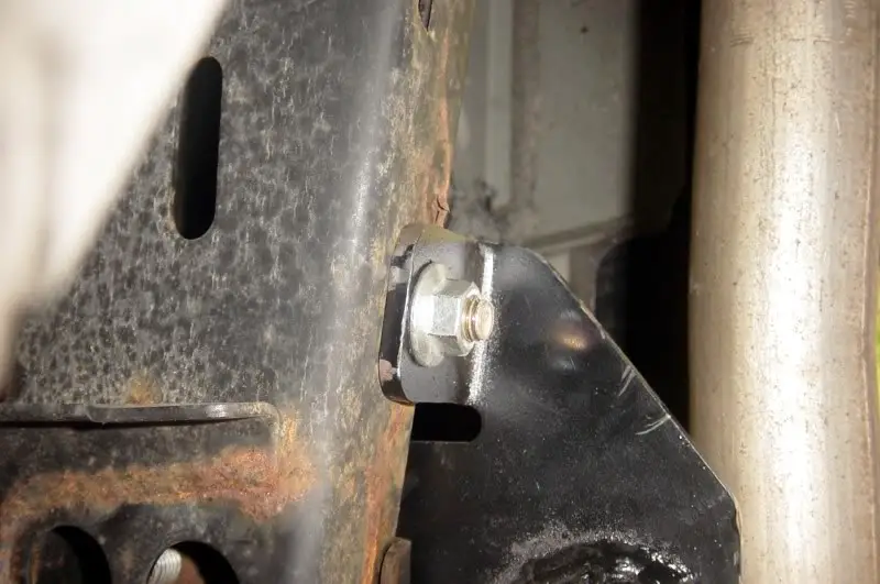

I also had to install new bolts that had to be slid into the rear of the frame and dropped into a hole. This sucked

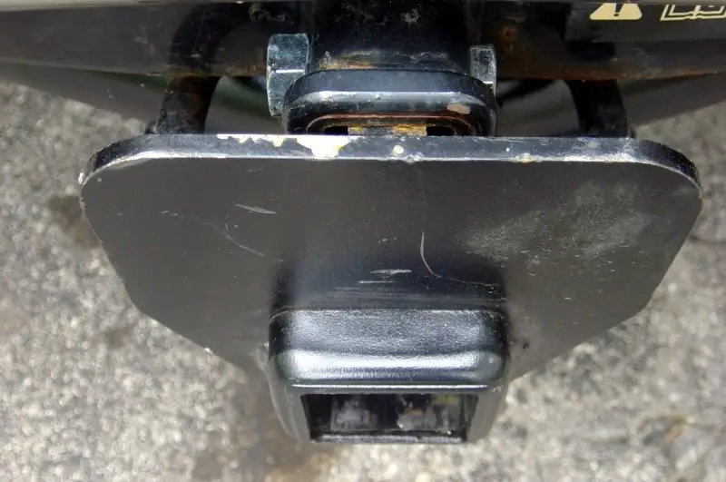

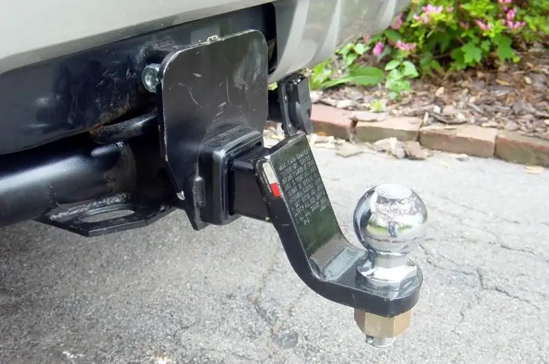

Its a very odd set up because the new hitch has a shank that goes into the class 2 hitch for support.

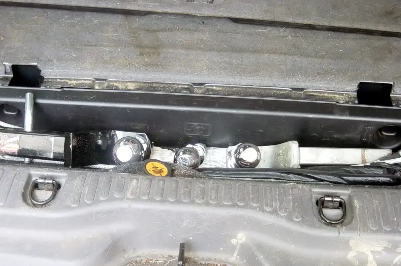

Hitch ball storage

Scince I upgraded the class 2 to a class 3 with the 3 still in place does this make mine a class 4 or more?
I saw a sport track today with a factory class 3 and the tow bar material looked as weak as my factory class 2
