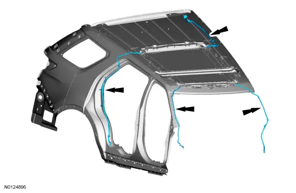

I know someone who was at the test facility within the last 6 months where NHTSA was testing for exhaust intrusion into the cabin on the PI Explorers. Yes, they used colored smoke and interior cameras as one of the tests. My source told me one of the biggest offenders allowing the exhaust fumes/CO into the rear hatch area was the moonroof drain, my guy said I should put tape over it. Looking it over it appeared to be a perfect size for a foam earplug and since I ride motorcycles I have plenty of them. Done and fixed. As far as flaps and other sources of intrusion, I'll just let the debate rage on.

That's a new revelation. FYI here is a diagram of the moonroof drain tube locations.

Hmmm, wonder how many of the people that have issues have sunroof. I could see that being an issue, especially if you have the sunroof open.
Do PI Explorers have the option of a sunroof?

I believe this came up before and the answer was that the PIU does not have the moonroof option. One reason may be that it would take away places tp mount antennas.

If air comes in thru the drain holes into the cabin, how come rain water does not come thru the drain holes and into the cabin?

It's much easier to draw in gases/air than to pull water in. If I understand his issue, it happens when the moonroof is open. The draft created would cause the fumes to be pulled in through the rear opening. He would not have the same issue when it's closed due to the rain.

As you stated, it is only a source. There are other sources that have been identified as well. This is just a new one to consider. Actually I have posted that drain tube diagram several times and must admit I never actually noticed that one of them goes to the back of the vehicle.:oops:
Peter
Ok but where does the water go that use to flow thru the moon roof drain?

The water that goes through that particular drain would normally run out along the side of the liftgate. I would guess that if it is plugged that the water would likely back up toward the moonroof. Not sure if there is a connection between it and the other drains. If not, it may begin to leak inside, but that is only a guess. :dunno:
