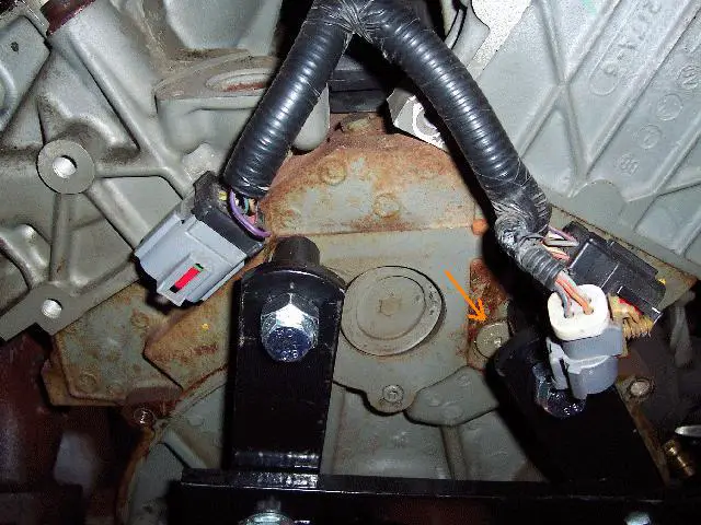

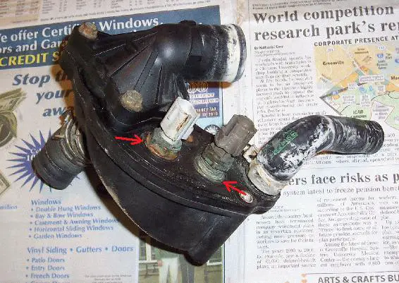

thermostat housing
The thermostat housing on the SOHC V6 frequently develops leaks.
The leak runs down the valley and drips at the rear of the block.
The large round plug is the jackshaft rear plug. It is not a freeze plug.
Don't assume that you have a blown head gasket which is more common in the OHV V6.
"The thermostat housing on the SOHC V6 frequently develops leaks...Don't assume that you have a blown head gasket which is more common in the OHV V6."
