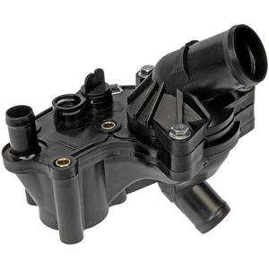

(5) At this point I removed the top radiator hose from the Thermostat housing and swung it out of the way. I then loosened up the (3) Thermostat housing nuts using a 1/4" rachet, with a 6 inch extension and a 8mm socket. I then pulled off the upper theromostat housing (also made out of plastic) cover. It came off rather easily. At this point I could see the top half of the thermostat, take a good look at what position it is in sitting in the housing and where the tubular gasket is positioned. This is where your new gasket will go. I attempted to pull the thermostat out using only my fingers and it was a little stuck in there, so with a pair of pliers, I gently grabbed on to it and used a little extra leverage and it popped out by pulling straight up on it. I wasn't worried about damaging the old thermostat since I was replacing it with a new one. I wiped off and inspected the thermostat housing cover and it's underside lip that rests on the tubular gasket and the mounting plate it sits in. It was quite clean to my surprise, not much of anything to clean off. The condition of the old coolant was surprisingly clean looking and very little if any particles were found at the bottom of the "clean" bucket I began with. No rust seen. I then installed the new thermostat (Stant 195 degree), positioning it inline with the flow of the upper radiator hose, followed by placing the new housing cover "gasket" (Felpro). Once that was in place, I replaced the thermostat housing cover plate and finger tightened the (3) 8 mm bolts that hold it down. I then used a 1/4" drive, torque wrench set to "89 inch/lbs" to finish tightening down the 3 bolts. Then I reattached the upper radiator hose to the thermostat housing cover. I reused the factory hose clamps since they appeared to be in "like new" condition.
