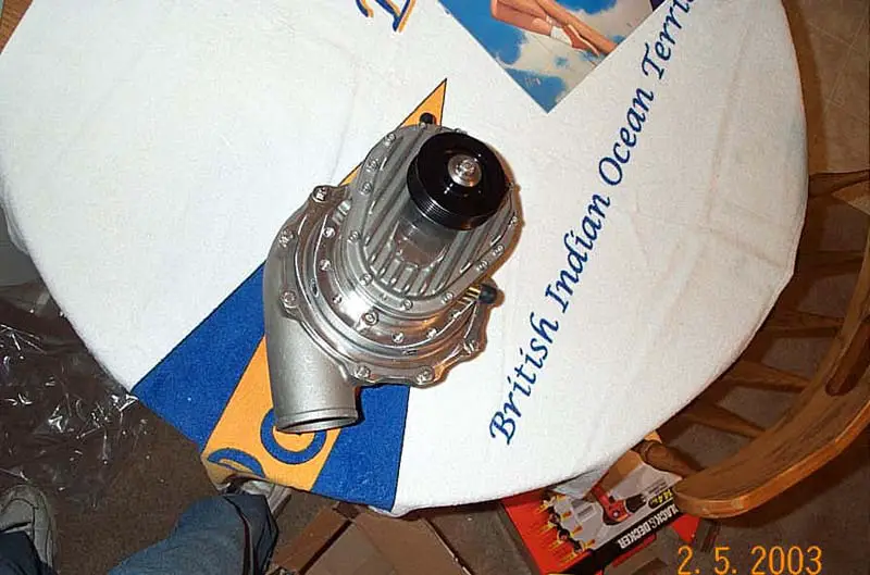

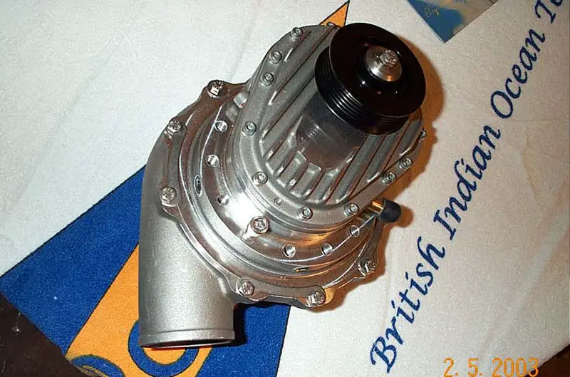

ok well the headline pretty much explains it all. ordered the s/c a while ago and it should finally ship today. thank god. well i have been researching this thing for quite some time just seeing here and there what i need to do to be able to safely and effectively run a setup with 9 lbs of boost and a 75 or mayyyyyybe 100 hp shot of nitrous. My plans are to of course get the s/c which is already on its way. get a custom burned flipchip with settings for s/c retardation boost, and retarded for boost and N20 from dan @ speedfreak. 80mm MAS. stage 4 baumann shift kit. 36 lb/hr injectors, and then of course a little later the nitrous kit when other money allows. now what i want to know is would it just be reccomended or durn near NEEDED being that i am going to be running bigger injectors to run a higher flow fuel pump? or would the in line fuel pump be enough? would you think the lightning fuel pump be good for this type of application? any prices on this or any others recommended? this question only really applies to the fuel and electronics systems. i plan on doing alot more with the engine later on but not right now with my funds i have. thanks for any advice or opinions.
